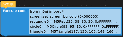

<p dir="auto">not ideal, but you could try the following: while your M5Stack application is loaded in UIFlow, get the rectangles, circles and triangles definitions from the python view. E.g.</p>
<pre><code>rectangle0 = M5Rect(35, 38, 30, 30, 0xFFFFFF, 0xFFFFFF)
circle0 = M5Circle(93, 95, 15, 0xFFFFFF, 0xFFFFFF)
triangle0 = M5Triangle(137, 120, 106, 149, 166, 149, 0xFFFFFF, 0xFFFFFF)
</code></pre>
<p dir="auto">then switch to M5Core2 and add those definitions together with:</p>
<pre><code>from m5ui import *
screen.set_screen_bg_color(0x000000)
</code></pre>
<p dir="auto">into an Execute Code block at the beginning of your M5Core2 application. E.g.</p>
<p dir="auto"><img src="/assets/uploads/files/1664784735939-uiflowshapesinexecuteblock20221003.png" alt="0_1664784734156_UIFlowShapesInExecuteBlock20221003.png" class=" img-fluid img-markdown" /></p>
<p dir="auto">If you programmatically changed those shapes you probably need to put those commands into Execute Code blocks as well.</p>
<p dir="auto">I guess one alternative is to stay in the Python view altogether or to use the shapes from the M5Core2 Graphic section.</p>
<p dir="auto">Thanks<br />
Felix</p>
