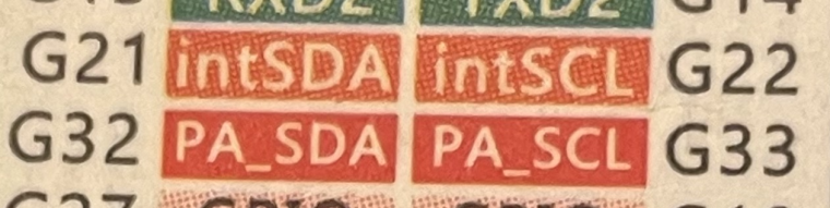

<p dir="auto">ok, for some reason the compiler / linker thinks you are using an M5Stack. Is there a way you can select the board you are using? It should be M5Core2.</p>
<p dir="auto">Alternatively you can try to force it to use the correct GPIOs for M5Core2 by replacing this line:</p>
<pre><code>    sensor.begin();
</code></pre>
<p dir="auto">with</p>
<pre><code>    sensor.begin(&amp;Wire, 0x40, 32, 33);
</code></pre>

<pre><code>SDA: 21 SCL: 22
_sda: 21 _scl: 22
</code></pre>
<p dir="auto">The sticker on bottom of the Core2 :<br />
<img src="/assets/uploads/files/1664812422143-45b23e0b-b792-468a-8321-9e7f07f4285b-afbeelding-resized.png" alt="0_1664812413941_45b23e0b-b792-468a-8321-9e7f07f4285b-afbeelding.png" class=" img-fluid img-markdown" /></p>
]]></description><link>https://community.m5stack.com/post/18791</link><guid isPermaLink="true">https://community.m5stack.com/post/18791</guid><dc:creator><![CDATA[Marelli7]]></dc:creator><pubDate>Mon, 03 Oct 2022 15:53:55 GMT</pubDate></item><item><title><![CDATA[Reply to [SOLVED] Core2 - how to fix the error: call of overloaded &#x27;begin(int ....)&#x27; is ambiguous on Mon, 03 Oct 2022 15:40:17 GMT]]></title><description><![CDATA[<p dir="auto">Hello <a class="plugin-mentions-user plugin-mentions-a" href="/user/marelli7" aria-label="Profile: Marelli7">@<bdi>Marelli7</bdi></a></p>

<p dir="auto">hmm, since the example was for M5Stack I am wondering if the correct GPIOs are defined for the external I2C on port A. (M5Stack uses 21 and 22 whereas M5Core2 uses 32 and 33.)<br />
Could you try to add the following lines just before <code>_wire-&gt;begin((int)_sda, (int)_scl, _speed);</code> in <code>Unit_Encoder.cpp</code>:</p>
<pre><code>Serial.printf("SDA: %d SCL: %d\n", SDA, SCL);
Serial.printf("_sda: %d _scl: %d\n", _sda, _scl);
</code></pre>
<p dir="auto">then post the debug output here? Both SDA and _sda should be 32 and both SCL and _scl should be 33.</p>
