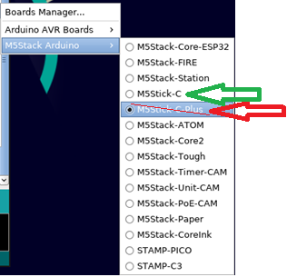

<p dir="auto">other users: switching to the M5Stick-C (no "-plus") platform allowed me to upload new sketches to the device.<br />
<img src="/assets/uploads/files/1665178522870-3412d667-e1c3-43ad-88dd-97a04a107d2d-image.png" alt="0_1665178518532_3412d667-e1c3-43ad-88dd-97a04a107d2d-image.png" class=" img-fluid img-markdown" /></p>
]]></description><link>https://community.m5stack.com/post/18893</link><guid isPermaLink="true">https://community.m5stack.com/post/18893</guid><dc:creator><![CDATA[M5_Tinker]]></dc:creator><pubDate>Fri, 07 Oct 2022 21:36:16 GMT</pubDate></item><item><title><![CDATA[Reply to esptool write_flash: error: argument : Address &quot;{upload.erase_cmd}&quot; must be a number on Fri, 07 Oct 2022 21:15:15 GMT]]></title><description><![CDATA[<p dir="auto">the file does actually show the "-e".  What <em>should</em> it be?<br />
