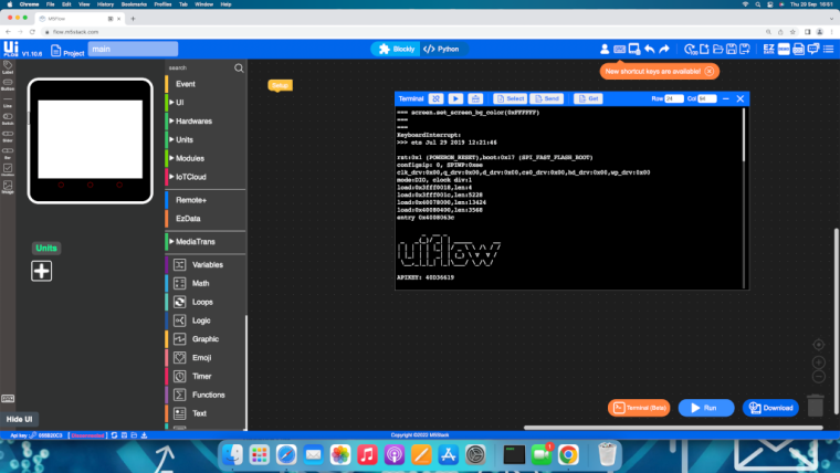

I learned that the browser does connect to the Core2 by WiFi and the IDE connects using USB.</p>

Click on the Icon next to the word "Terminal" open the device list, select the core two device to connect then hit the reset button on the core and the code will appear after the uiflow logo shows.<br />
<img src="/assets/uploads/files/1665030703188-terminalapi-resized.png" alt="0_1665030693127_terminalapi.png" class=" img-fluid img-markdown" /></p>

<p dir="auto">Found it* ...<br />
But, then whát to do to connect?<br />
The Terminal reports connected, the UIFlow screen show [<code>disconnected</code>]<br />
<img src="/assets/uploads/files/1664987451571-naamloos.png" alt="0_1664987448885_Naamloos.png" class=" img-fluid img-markdown" /><br />
*This Orange Terminal (Beta) button is also displayed when using another browser.</p>
