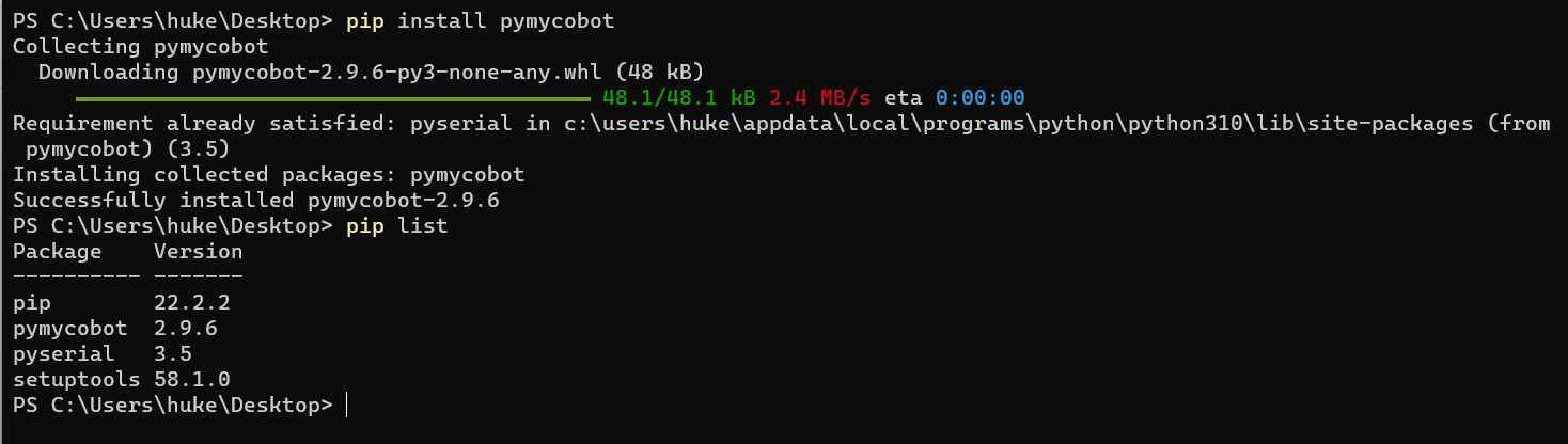

After installing the programming environment, we download the driver library.<br />
<code>pip install pymycobot</code><br />
<img src="/assets/uploads/files/1665476252516-1-resized.png" alt="0_1665476252556_1.png" class=" img-fluid img-markdown" /></li>

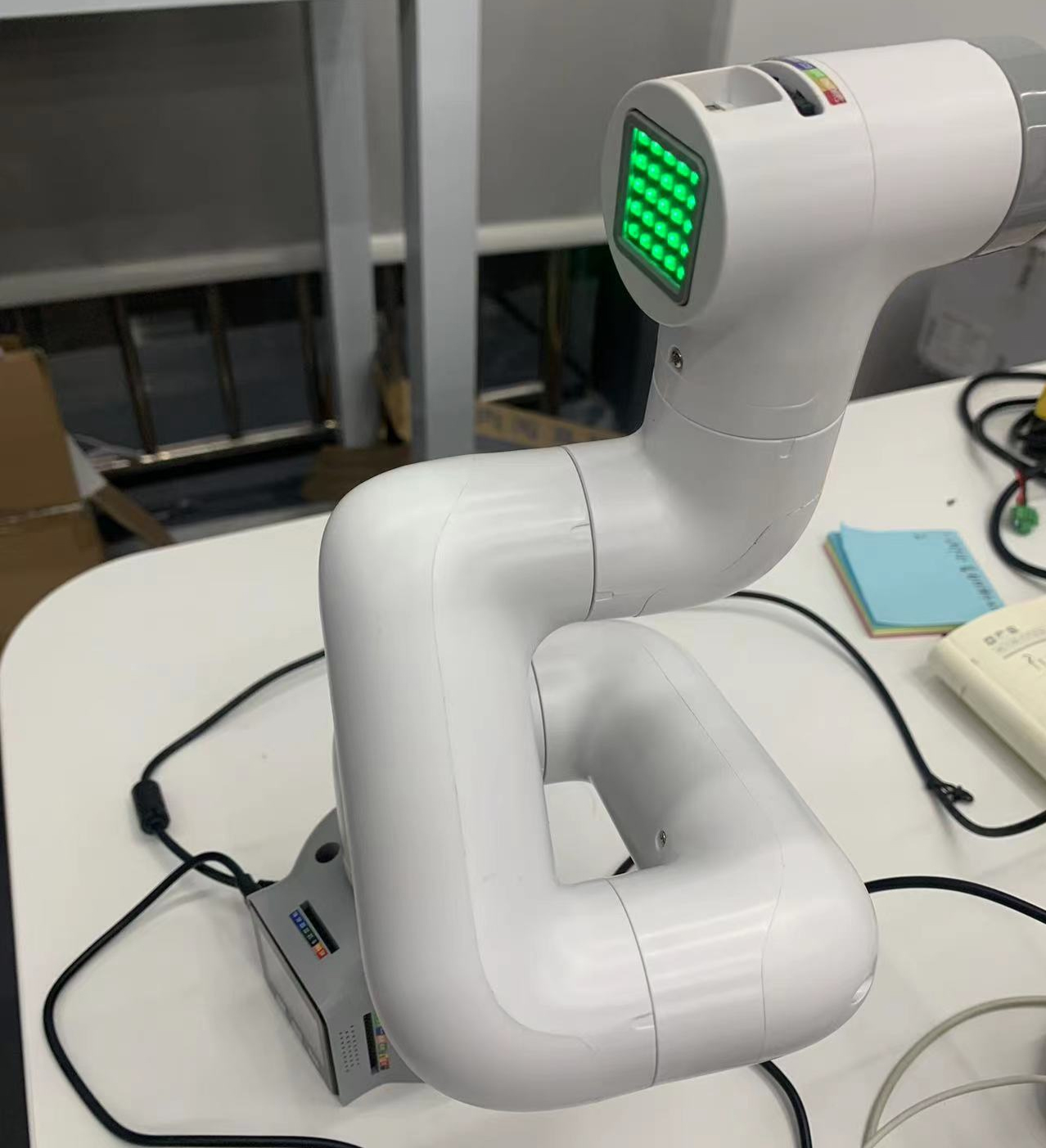

<img src="/assets/uploads/files/1665476468062-2-resized.png" alt="0_1665476468102_2.png" class=" img-fluid img-markdown" /><br />
We can see the angles of myCobot as shown<br />
<img src="/assets/uploads/files/1665476639591-3-1-resized.jpg" alt="0_1665476638997_3。1.jpg" class=" img-fluid img-markdown" /></p>
