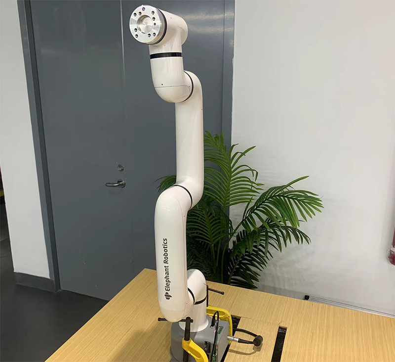

<p dir="auto"><a href="https://shop.elephantrobotics.com/collections/mycobot-pro-600/products/mycobot-pro-600-2kg-payload-commercial-6-dof-cobot" target="_blank" rel="noopener noreferrer nofollow ugc">myCobot Pro 600</a> is a robotic arm developed for education and commercial use with a Raspberry Pi microprocessor and embedded RoboFlow visual programming primitives from Elephant Robotics.myCobot Pro 600 uses an industrial grade servo, which is comparable to an industrial robotic arm. It is very good in this aspect of stability and can be a painter.<br />
（What is RobotFlow is described below.）<br />
<img src="/assets/uploads/files/1665741803296-111.1-resized.jpg" alt="0_1665741802296_111.1.jpg" class=" img-fluid img-markdown" /></p>

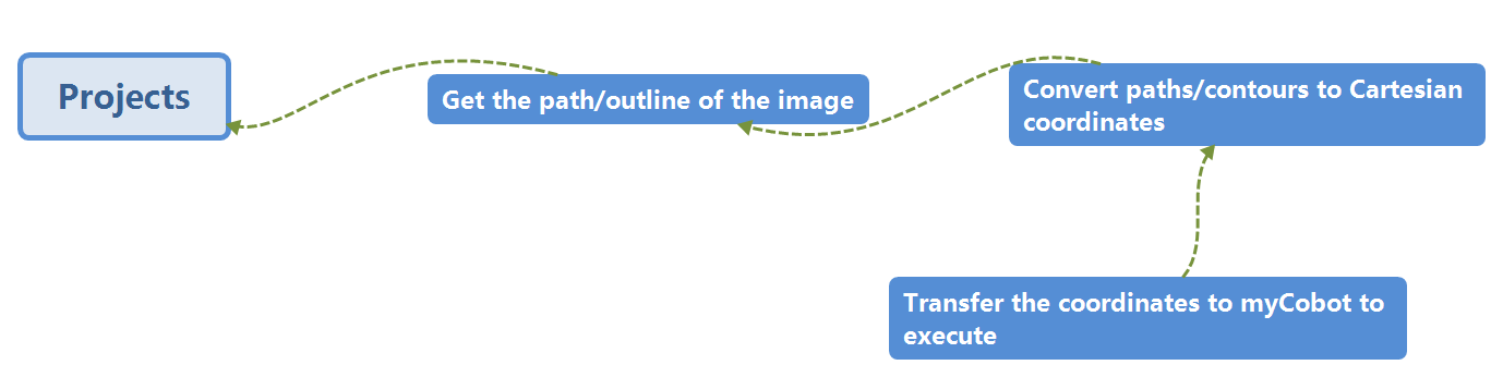

<p dir="auto">The first step is to get the outline of a photo, transform it to get the Cartesian coordinates of the outline, transfer it to the robotic arm to execute along the path, and then the robotic arm will be able to draw.<br />
Projects<br />
<img src="/assets/uploads/files/1665741521900-projects-resized.png" alt="0_1665741521390_Projects.png" class=" img-fluid img-markdown" /></p>
<h2>Key points:</h2>
<p dir="auto">1 Get the path/contour map of the image and convert it to Cartesian coordinates.</p>
<p dir="auto">2 The recognition of the pen up point and down point positions in the contour of the image.</p>
