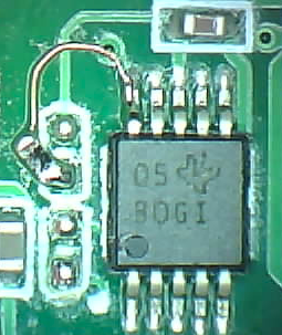

]]></description><link>https://community.m5stack.com/topic/4721/m5-stack-ads1115-address</link><generator>RSS for Node</generator><lastBuildDate>Sat, 16 May 2026 03:04:38 GMT</lastBuildDate><atom:link href="https://community.m5stack.com/topic/4721.rss" rel="self" type="application/rss+xml"/><pubDate>Sun, 16 Oct 2022 19:27:04 GMT</pubDate><ttl>60</ttl><item><title><![CDATA[Reply to M5 Stack ADS1115 address on Mon, 17 Oct 2022 00:06:26 GMT]]></title><description><![CDATA[<p dir="auto">Hello <a class="plugin-mentions-user plugin-mentions-a" href="/user/nebosa" aria-label="Profile: nebosa">@<bdi>nebosa</bdi></a></p>
<p dir="auto">check the ADS1115 datasheet (linked <a href="https://docs.m5stack.com/en/unit/ameter" target="_blank" rel="noopener noreferrer nofollow ugc">here</a> under Related Link). <em>Section 9.5.1.1 I2C Address Selection</em> describes how to change the I2C address.</p>
<p dir="auto">Looking at the board of my <a href="https://docs.m5stack.com/en/unit/ameter" target="_blank" rel="noopener noreferrer nofollow ugc">AMeter</a> I can see that it is partly prepared to select a different I2C address. One can move a 10 k resistor from one location to another to switch between 0x48 (default) and 0x49. To select 0x4A or 0x4B requires a bit more work, I am afraid.</p>
<p dir="auto">Below picture illustrates my modification to change the AMeter I2C address to 0x4B.</p>
<p dir="auto"><img src="/assets/uploads/files/1665964944391-m5stackameteri2caddr0x4b_20221017.png" alt="0_1665964942025_M5StackAMeterI2CAddr0x4B_20221017.png" class=" img-fluid img-markdown" /></p>
<p dir="auto">Thanks<br />
Felix</p>
