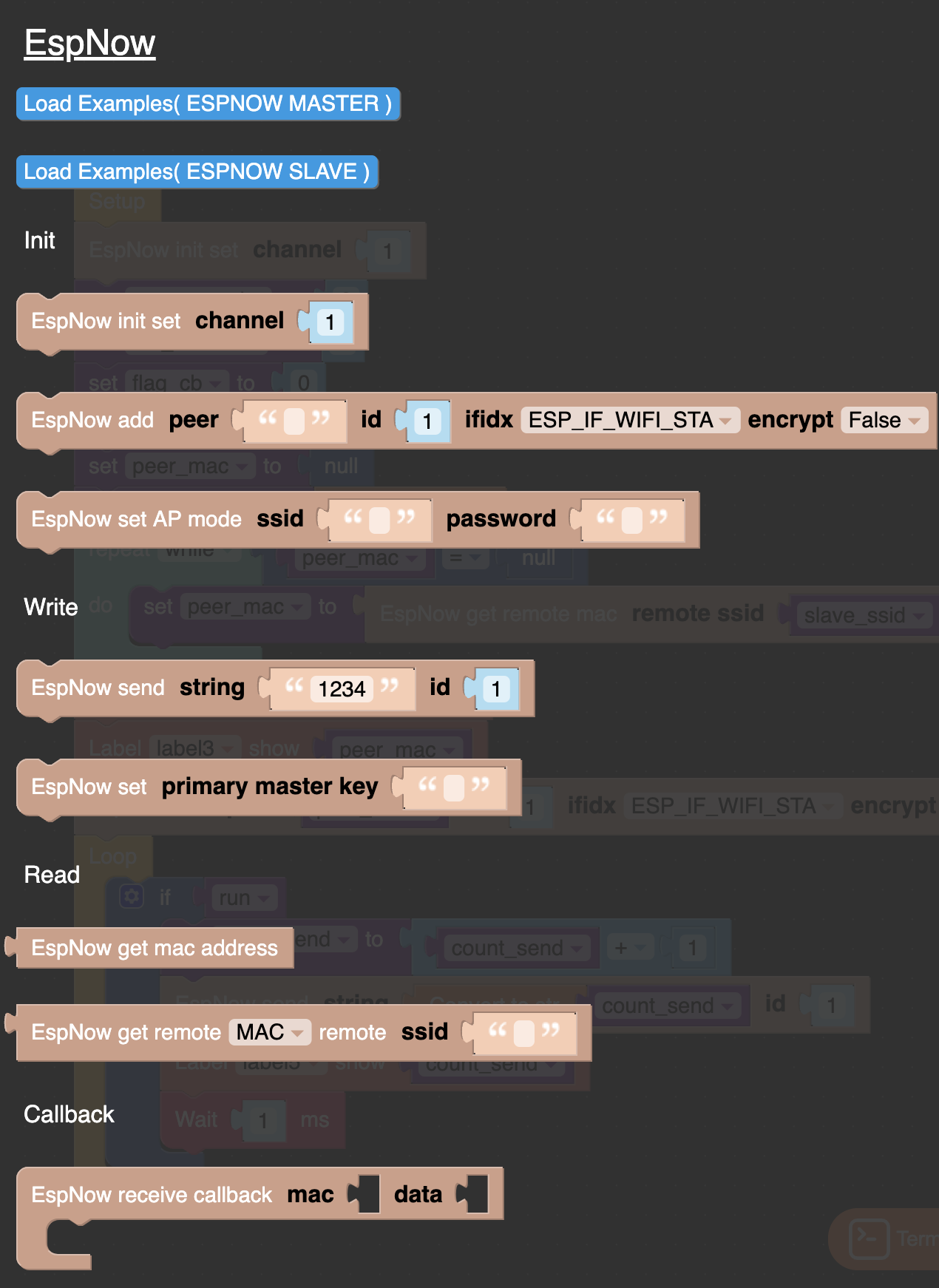

2 days ago, working on the project again after 2 month of work on others, I discovered that ESPNow have been completely rebuilt in UIFlow. And that it completely broke the work of my project (a quite costy and important for the company am working for)...<br />
<img src="/assets/uploads/files/1666364970013-capture-d-e-cran-2022-10-21-a-17.08.29-resized.png" alt="0_1666364946184_Capture d’écran 2022-10-21 à 17.08.29.png" class=" img-fluid img-markdown" /><br />
I didn't find any explanation about that anywhere in the community or wiki (but maybe somebody could tell me where to find some). Then I tried using the new ESPNow examples in UIFlow : Master &amp; Slave (the manual haven't be updated sadly). And no success. Error everywhere in the examples. Black screen. These examples haven't been tested it seems.<br />
<img src="/assets/uploads/files/1666365073235-capture-d-e-cran-2022-10-21-a-17.10.45.png" alt="0_1666365065679_Capture d’écran 2022-10-21 à 17.10.45.png" class=" img-fluid img-markdown" /></p>
<p dir="auto">My question is : how could I manage to make this project working again with ESPNow new implementation in UIFlow ? Did somebody succeed to use it again ? And more, are M5Stack engineers  aware of this problem ? Are they / you working on it at the moment ? With the lack of documentation and working examples, it cost me a lot of time and maybe for nothing.</p>

thanks a lot for your advices.<br />
I will look at micropython side but I'm very concerned by the fact that the UIFlow blocks I used have been deprecated without notice. I'm on a very bug hurry now.<br />
I went back to V1.9.8 firmware on my M5StickCPlus and M5Core and everything is working again now. At least temporarily.<br />
