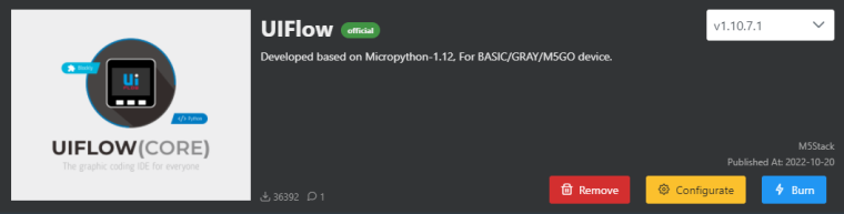

<p dir="auto">I'am loading Core firmware as below:</p>
<p dir="auto"><img src="/assets/uploads/files/1666688634560-uiflow-core0-resized.png" alt="0_1666688579010_uiflow core0.png" class=" img-fluid img-markdown" /></p>
