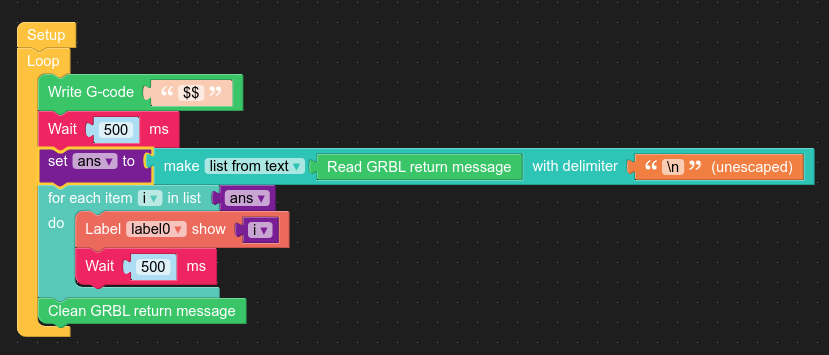

<p dir="auto">I'm trying to configure correctly a GRBL module using a Core2 in UiFlow but I'm having problems to get current configuration values using this simple program:<br />
<img src="/assets/uploads/files/1667602439901-29f4e991-088e-41ed-997a-45894aeaf586-image-resized.png" alt="0_1667602438533_29f4e991-088e-41ed-997a-45894aeaf586-image.png" class=" img-fluid img-markdown" /><br />
It seems that there is <strong>some limit in the quantity of information (chars)</strong> that can be received by Read GRBL return message. ¿Do anyone have a tip or work around to this specific issue?</p>

]]></description><link>https://community.m5stack.com/post/19497</link><guid isPermaLink="true">https://community.m5stack.com/post/19497</guid><dc:creator><![CDATA[Peti73]]></dc:creator><pubDate>Fri, 09 Dec 2022 21:01:16 GMT</pubDate></item><item><title><![CDATA[Reply to GRBL data transmission limit. on Mon, 07 Nov 2022 16:59:42 GMT]]></title><description><![CDATA[<p dir="auto">I've some experience with GRBL already. The $$ command should return a list of parameters and the corresponding values. The command works in the module and the GRBL returns the values. However, it seems that the message is truncated. I suspect that maybe some buffer limit in the i2c connection or something like that and I wonder if it could be fixed in Core2 side.</p>
<p dir="auto">The number of chars received correctly is stable (usually the message is truncated at the same place) and there is some random chars at the end.</p>
