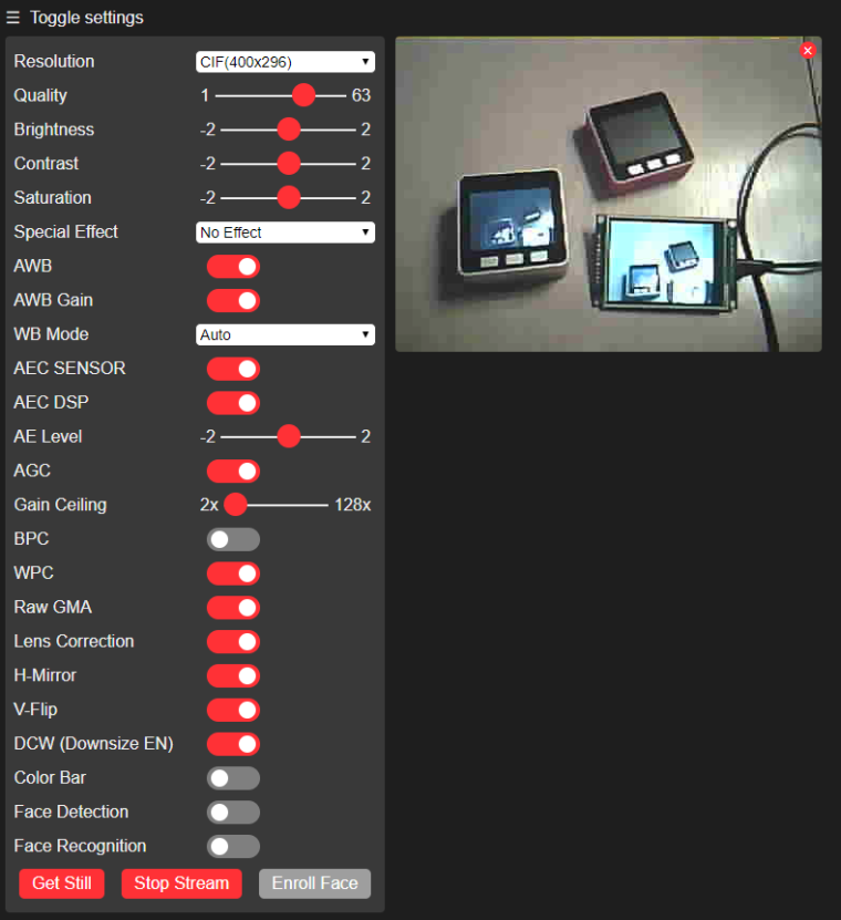

<?xml version="1.0" encoding="UTF-8"?><rss xmlns:dc="http://purl.org/dc/elements/1.1/" xmlns:content="http://purl.org/rss/1.0/modules/content/" xmlns:atom="http://www.w3.org/2005/Atom" version="2.0"><channel><title><![CDATA[M5Stack Camera Streaming]]></title><description><![CDATA[<p dir="auto">Here is a repository with 2 projects on it: <a href="https://github.com/botofancalin/ESP32_Camera_System.git" target="_blank" rel="noopener noreferrer nofollow ugc">https://github.com/botofancalin/ESP32_Camera_System.git</a></p>
<ul>
<li>A camera software for M5Stack camera</li>
<li>A M5Stack software that can recieve the video stream from M5Stack camera and display it on the screen.</li>
</ul>
<p dir="auto">The projects can be compiled using PlatformIO</p>
<p dir="auto">The camera stream can be accessed from browser too and can set various settings on it, while running:</p>
<p dir="auto"><img src="/assets/uploads/files/1546809984516-untitled-resized.png" alt="0_1546809980628_Untitled.png" class=" img-fluid img-markdown" /></p>
