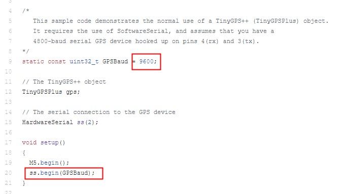

No baud in HardwareSerial but Baud in GPS module config, what is the correct NMEA string to config Serial Baud rate communication from GPS to HOST and what is the correct sentence to ser 10hz frequency?<br />
es. $GPTXT.......</p>

<p dir="auto">I think you need to reinitialize GPS Unit for changing baudrate.</p>
<p dir="auto"><img src="/assets/uploads/files/1547092813157-set_baudrate.jpg" alt="0_1547092812769_set_baudrate.JPG" class=" img-fluid img-markdown" /></p>

how can I change gps serial boud rate?<br />
and how can I use 10hz sample rate?</p>
