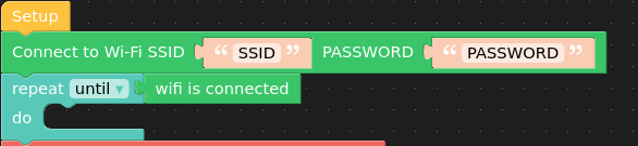

]]></description><link>https://community.m5stack.com/post/19398</link><guid isPermaLink="true">https://community.m5stack.com/post/19398</guid><dc:creator><![CDATA[kilnageer]]></dc:creator><pubDate>Tue, 29 Nov 2022 08:43:23 GMT</pubDate></item><item><title><![CDATA[Reply to UI Flow MQTT code on M5Stack Core works when run from flow.m5stack.com but not (MQTTException -&gt; 128) when downloaded to device on Mon, 28 Nov 2022 10:54:32 GMT]]></title><description><![CDATA[<p dir="auto">Hello <a class="plugin-mentions-user plugin-mentions-a" href="/user/kilnageer" aria-label="Profile: kilnageer">@<bdi>kilnageer</bdi></a></p>
<p dir="auto">when the code is downloaded to the device and is run in app mode, WiFi might no longer be connected. Try adding below blocks to your program to ensure WiFi is connected.</p>
<p dir="auto"><img src="/assets/uploads/files/1669632751019-uiflowwifi_20221128.png" alt="0_1669632749798_UiFlowWiFi_20221128.png" class=" img-fluid img-markdown" /></p>
