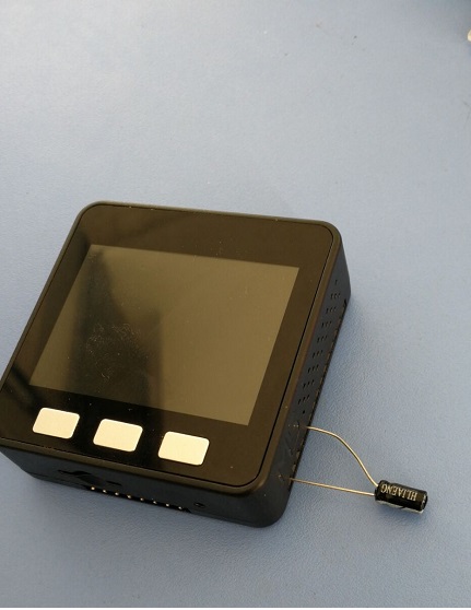

]]></description><link>https://community.m5stack.com/post/2488</link><guid isPermaLink="true">https://community.m5stack.com/post/2488</guid><dc:creator><![CDATA[JLab]]></dc:creator><pubDate>Mon, 14 Jan 2019 08:59:09 GMT</pubDate></item><item><title><![CDATA[Reply to M5Fire - No USB COM. on Fri, 11 Jan 2019 11:37:41 GMT]]></title><description><![CDATA[<p dir="auto"><img src="/assets/uploads/files/1547206660878-tim%E5%9B%BE%E7%89%8720190111192612-%E5%89%AF%E6%9C%AC.jpg" alt="0_1547206661062_TIM图片20190111192612 - 副本.jpg" class=" img-fluid img-markdown" /></p>
]]></description><link>https://community.m5stack.com/post/2453</link><guid isPermaLink="true">https://community.m5stack.com/post/2453</guid><dc:creator><![CDATA[m5-docs]]></dc:creator><pubDate>Fri, 11 Jan 2019 11:37:41 GMT</pubDate></item><item><title><![CDATA[Reply to M5Fire - No USB COM. on Thu, 10 Jan 2019 17:53:25 GMT]]></title><description><![CDATA[<p dir="auto"><a class="plugin-mentions-user plugin-mentions-a" href="/user/dreitagebert" aria-label="Profile: dreitagebert">@<bdi>dreitagebert</bdi></a> said in <a href="/post/2436">M5Fire - No USB COM.</a>:</p>

But now it starts as it should.</p>
<p dir="auto">I took the backside off and plugged the capacitor in without soldering. (Maybe therefor i had to try several times)</p>
<p dir="auto">Very strange and not funny for people with lesser frustration tolerance.</p>

I would like to avoid soldering as it is under waranty. The issue that can be fixed with a capacitor is on all FIRE models?</p>
<p dir="auto">If not I prefer to send back the module and order another one.</p>
<p dir="auto">One more question : Is it normal that the screen part of the module is not able to boot even with USB plugged in if back cover is not stacked?</p>
]]></description><link>https://community.m5stack.com/post/2432</link><guid isPermaLink="true">https://community.m5stack.com/post/2432</guid><dc:creator><![CDATA[JLab]]></dc:creator><pubDate>Thu, 10 Jan 2019 09:59:21 GMT</pubDate></item><item><title><![CDATA[Reply to M5Fire - No USB COM. on Thu, 10 Jan 2019 08:54:21 GMT]]></title><description><![CDATA[<p dir="auto"><s>You just push it into the RST and GND pin in the base.</s> this only works on the core.</p>
<p dir="auto">Yes looks like you need to solder it to the pins in the base.<br />
Have you installed the CP2x driver yet?</p>
<p dir="auto">As a last try you will need a USB to UART adapter which M5Stack has now just added an approved model to their store.</p>

<p dir="auto">How did U manage to connect the capacitor?</p>
<p dir="auto">If i unscrew the back of the M5Fire, I do get access to the 2x15 connector. but there is no room to connect a capacitor and screw the back. If I do not screww the back, module won't start (even with USB plugged)</p>
