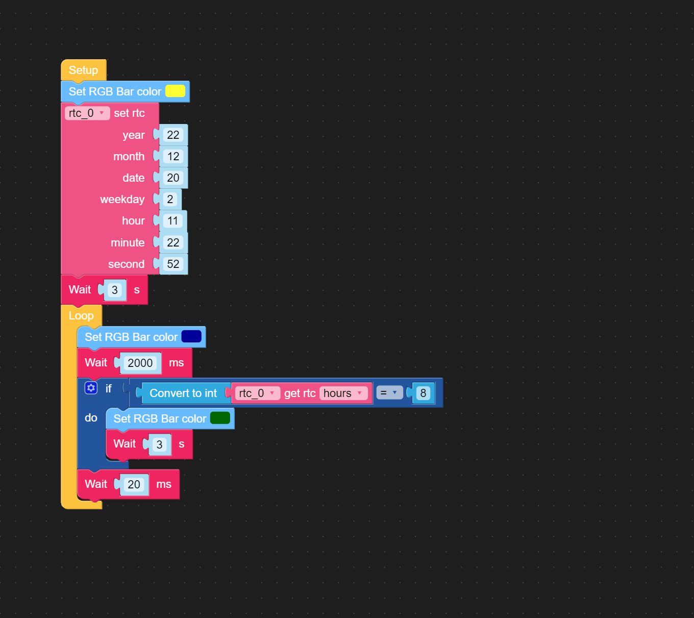

<?xml version="1.0" encoding="UTF-8"?><rss xmlns:dc="http://purl.org/dc/elements/1.1/" xmlns:content="http://purl.org/rss/1.0/modules/content/" xmlns:atom="http://www.w3.org/2005/Atom" version="2.0"><channel><title><![CDATA[RTC UI Flow - GET RTC doesn&#x27;t work]]></title><description><![CDATA[<p dir="auto">Hi,<br />
I am struggling with RTC module M5Unit-RTC: <a href="https://docs.m5stack.com/en/unit/rtc" target="_blank" rel="noopener noreferrer nofollow ugc">https://docs.m5stack.com/en/unit/rtc</a></p>
<p dir="auto">I know it's working, and powered on, because it responds correctly to alarm, and timer commands.</p>
<p dir="auto">However when I try to use the GET RTC (seconds) command it fails.<br />
I tried everything: changing it to int(), assigning a variable with the get_rtc() - nothing helps</p>
<p dir="auto">I am attaching an example.<br />
<img src="/assets/uploads/files/1671572058154-8ef40cad-0d64-4f32-b50f-30fc6e51510f-image-resized.png" alt="0_1671572056411_8ef40cad-0d64-4f32-b50f-30fc6e51510f-image.png" class=" img-fluid img-markdown" /></p>
<p dir="auto">The behavior is as follows:</p>
<ul>
<li>LED turns to yellow (inicialized)<br />
after 3 sec LED turns to Blue (the date and time is set)<br />
Instead of going to green the LED goes to &lt;red&gt; the moment a line with get_rtc command is being run.<br />
It's always the same with every other things I try. The moment I use this block the LED turns red and stops working.</li>
</ul>
<p dir="auto">I am looking forward to hearing your thoughts<br />
Michal</p>
]]></description><link>https://community.m5stack.com/topic/4911/rtc-ui-flow-get-rtc-doesn-t-work</link><generator>RSS for Node</generator><lastBuildDate>Wed, 29 Apr 2026 15:45:51 GMT</lastBuildDate><atom:link href="https://community.m5stack.com/topic/4911.rss" rel="self" type="application/rss+xml"/><pubDate>Tue, 20 Dec 2022 21:36:40 GMT</pubDate><ttl>60</ttl><item><title><![CDATA[Reply to RTC UI Flow - GET RTC doesn&#x27;t work on Sat, 24 Dec 2022 22:21:38 GMT]]></title><description><![CDATA[<p dir="auto">Hi,<br />
I am using Atom Lite. It's the one from ATOM Stepper Motor Driver Development Kit (DRV8825)<br />
I am using UIFLOW(LITE) v1.9.8 downloaded using the Burning Tool</p>
<p dir="auto">I checked if the Burnning Tool would update the UIFLOW version, but I did not download the newest Burning Tool version. That must have been a mistake.</p>
<p dir="auto">Now I downloaded the newest Burning Tool with UIFLOW 1.11.0 on board and it is working correctly.<br />
Thank you Felix. Much appreciated!</p>
]]></description><link>https://community.m5stack.com/post/19650</link><guid isPermaLink="true">https://community.m5stack.com/post/19650</guid><dc:creator><![CDATA[mickud]]></dc:creator><pubDate>Sat, 24 Dec 2022 22:21:38 GMT</pubDate></item><item><title><![CDATA[Reply to RTC UI Flow - GET RTC doesn&#x27;t work on Wed, 21 Dec 2022 19:57:27 GMT]]></title><description><![CDATA[<p dir="auto">Hello <a class="plugin-mentions-user plugin-mentions-a" href="/user/mickud" aria-label="Profile: mickud">@<bdi>mickud</bdi></a></p>
<ul>
<li>which device (M5AtomLite, M5AtomMatrix, M5Stamp, ...) are you using?</li>
<li>what UIFlow firmware is running on your device?</li>
</ul>
<p dir="auto">I've tried with an M5AtomLite and M5StampPico (both UIFlow firmware version 1.11.0) and using <code>get_rtc</code> command works just fine for me.</p>
<p dir="auto">BTW: <code>convert to int</code> seem to be unnecessary.</p>
<p dir="auto">Thanks<br />
Felix</p>
