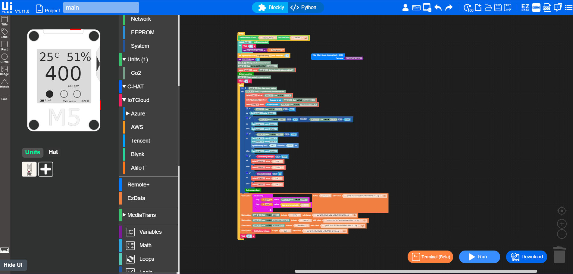

<p dir="auto">I am very new to this, so sorry if my question might be a bit too obvious.<br />
I have made a CO2 monitor on UIFLOW using CORE Ink and a CO2 module. it shows the data on the screen and also I used REMOTE+ to read the data on my phone.<br />
Everything works well for around 5 minutes and then Core INK freezes. I have no idea why.<br />
Can you please help me diagnose this?<img src="/assets/uploads/files/1672412564168-screenshot-2022-12-30-155652-resized.png" alt="0_1672412560299_Screenshot 2022-12-30 155652.png" class=" img-fluid img-markdown" /></p>
