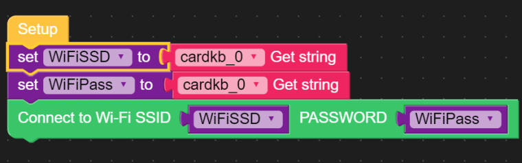

<?xml version="1.0" encoding="UTF-8"?><rss xmlns:dc="http://purl.org/dc/elements/1.1/" xmlns:content="http://purl.org/rss/1.0/modules/content/" xmlns:atom="http://www.w3.org/2005/Atom" version="2.0"><channel><title><![CDATA[Wifi settings tutorial]]></title><description><![CDATA[<p dir="auto">UIFlow, core2, does anyone have a tutorial, or screneshot, of what all is involved in allowing a user to change wifi ssid/password WITHOUT burning?</p>

<img src="/assets/uploads/files/1675362940447-e63945f5-0762-49b8-b380-39c36d386380-image.png" alt="0_1675362938829_e63945f5-0762-49b8-b380-39c36d386380-image.png" class=" img-fluid img-markdown" /><br />
Pressing &lt; &gt; you scroll through the alphabet, with OK you confirm the letter... Much like setting and confirming your wifi credentials on an android TV<br />
When finished you connect to the Wi-Fi with the SSID and Password.</p>

<blockquote>
<p dir="auto">CardKB unit</p>
</blockquote>
<p dir="auto">I should add I'm looking to do this without additional hardware</p>

<img src="/assets/uploads/files/1675363653567-a7a02a70-e8d9-480f-a250-f184d51449d9-image-resized.png" alt="0_1675363654050_a7a02a70-e8d9-480f-a250-f184d51449d9-image.png" class=" img-fluid img-markdown" /><br />
On the other hand you could use the simple touch keyboard:<br />
<a href="https://community.m5stack.com/topic/2324/simple-touch-keyboard">https://community.m5stack.com/topic/2324/simple-touch-keyboard</a></p>
