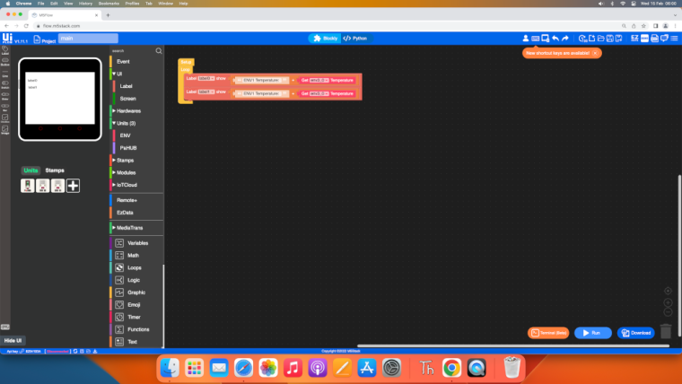

In UIFLow You can't connect the ENVIII sensor to PortB. ENVIII is an I2C device and has a red connector, PortB is for analog devices and has a black connector.<br />
Both ENVIII sensors have to be connected to PortA via the PAhub2 and then you need to make sure in the config that there are set to the individual PaHub ports not the Cores ports.<br />
The you need GUI labels to show the incoming data from the ENVIII sensors.<br />
<img src="/assets/uploads/files/1676440934236-screenshot-2023-02-15-at-06.00.31-resized.png" alt="0_1676440930453_Screenshot 2023-02-15 at 06.00.31.png" class=" img-fluid img-markdown" /></p>
<p dir="auto">The 1to3 mini hub is only usable if the I2C devices have different I2C hubs and the PortBHub is only usable for devices with the black "analog" connector.</p>

<p dir="auto">It seems, that my setup with two <a href="https://docs.m5stack.com/en/unit/envIII" target="_blank" rel="noopener noreferrer nofollow ugc">ENVIII</a> sensors connected (1st port A, 2nd Port B via <a href="https://shop.m5stack.com/collections/m5-modules/products/extension-port-module-for-core2" target="_blank" rel="noopener noreferrer nofollow ugc">ExtPort 2</a>) does not load the sensors properly and the program crashes.</p>
<p dir="auto">As comparison the program runs without a problem if the 2nd sensor is not connected into the Extension Port Module...</p>
<p dir="auto">What are your experiences to connect two ENVIII sensors to a Core2 at the same time?</p>
