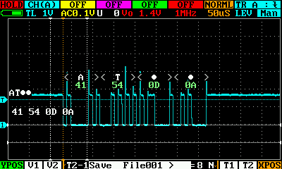

<p dir="auto">I agree, I wouldn't expect 3.3 V peaks at the U1_RX side of the Q3. And yes, I guess the transistor could be broken, but it being broken in three devices - that is a bit hard to imagine.</p>
<p dir="auto">I never have used the TinyGsmAutoBaud code myself. I normally run all my modems with just 115200 and so far that worked just fine.</p>
<p dir="auto">Have you tried to measure what comes out of the modem, e.g. at transistor Q5? Maybe you can determine from that what baudrate the modem expects?</p>
