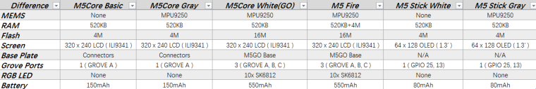

<?xml version="1.0" encoding="UTF-8"?><rss xmlns:dc="http://purl.org/dc/elements/1.1/" xmlns:content="http://purl.org/rss/1.0/modules/content/" xmlns:atom="http://www.w3.org/2005/Atom" version="2.0"><channel><title><![CDATA[A comparison of M5Stack&#x2F;Stick Models.]]></title><description><![CDATA[<p dir="auto">A comparison of M5Stack/Stick Models.<br />
<img src="https://i.pinimg.com/originals/c2/26/53/c2265381754b092083e6b0318967e7aa.png" alt="alt text" class=" img-fluid img-markdown" /><br />
Please do not share this outside of the forums as its from my book.<br />
<a class="plugin-mentions-user plugin-mentions-a" href="/user/m5stack" aria-label="Profile: m5stack">@<bdi>m5stack</bdi></a> is this accurate?</p>

<img src="/assets/uploads/files/1547602773211-core_comparison-resized.png" alt="0_1547602775444_core_comparison.png" class=" img-fluid img-markdown" /></p>
]]></description><link>https://community.m5stack.com/post/2521</link><guid isPermaLink="true">https://community.m5stack.com/post/2521</guid><dc:creator><![CDATA[m5-docs]]></dc:creator><pubDate>Wed, 16 Jan 2019 01:39:41 GMT</pubDate></item><item><title><![CDATA[Reply to A comparison of M5Stack&#x2F;Stick Models. on Tue, 15 Jan 2019 11:08:29 GMT]]></title><description><![CDATA[<p dir="auto"><a class="plugin-mentions-user plugin-mentions-a" href="/user/watson" aria-label="Profile: watson">@<bdi>watson</bdi></a> the M5Core Basic has a 150mAh battery in it.</p>

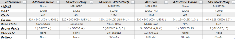

<p dir="auto"><a class="plugin-mentions-user plugin-mentions-a" href="/user/ajb2k3" aria-label="Profile: ajb2k3">@<bdi>ajb2k3</bdi></a><br />
Hey, here's the comparison with m5core and m5stick.</p>
<p dir="auto"><img src="/assets/uploads/files/1547523251253-core_comparison-resized.png" alt="0_1547523251298_core_comparison.png" class=" img-fluid img-markdown" /></p>
<p dir="auto"><a href="https://github.com/m5stack/M5-Schematic/blob/master/Core/m5core_m5stick_comparison.xlsx" target="_blank" rel="noopener noreferrer nofollow ugc">https://github.com/m5stack/M5-Schematic/blob/master/Core/m5core_m5stick_comparison.xlsx</a></p>
<p dir="auto">There is an error in that chart.<br />
The core has a battery.</p>
]]></description><link>https://community.m5stack.com/post/2506</link><guid isPermaLink="true">https://community.m5stack.com/post/2506</guid><dc:creator><![CDATA[ajb2k3]]></dc:creator><pubDate>Tue, 15 Jan 2019 05:45:04 GMT</pubDate></item><item><title><![CDATA[Reply to A comparison of M5Stack&#x2F;Stick Models. on Tue, 15 Jan 2019 03:37:32 GMT]]></title><description><![CDATA[<p dir="auto"><a class="plugin-mentions-user plugin-mentions-a" href="/user/ajb2k3" aria-label="Profile: ajb2k3">@<bdi>ajb2k3</bdi></a><br />
]]></description><link>https://community.m5stack.com/post/2504</link><guid isPermaLink="true">https://community.m5stack.com/post/2504</guid><dc:creator><![CDATA[m5-docs]]></dc:creator><pubDate>Tue, 15 Jan 2019 03:37:32 GMT</pubDate></item><item><title><![CDATA[Reply to A comparison of M5Stack&#x2F;Stick Models. on Mon, 14 Jan 2019 17:53:47 GMT]]></title><description><![CDATA[<p dir="auto">Corrected and will be visable in the next preview.</p>

]]></description><link>https://community.m5stack.com/post/2489</link><guid isPermaLink="true">https://community.m5stack.com/post/2489</guid><dc:creator><![CDATA[ajb2k3]]></dc:creator><pubDate>Mon, 14 Jan 2019 09:29:45 GMT</pubDate></item><item><title><![CDATA[Reply to A comparison of M5Stack&#x2F;Stick Models. on Mon, 14 Jan 2019 07:37:02 GMT]]></title><description><![CDATA[<p dir="auto">Great work so far. This is the issue <a class="plugin-mentions-user plugin-mentions-a" href="/user/watson" aria-label="Profile: watson">@<bdi>watson</bdi></a> was talking about, these should be 520kb not mb</p>
