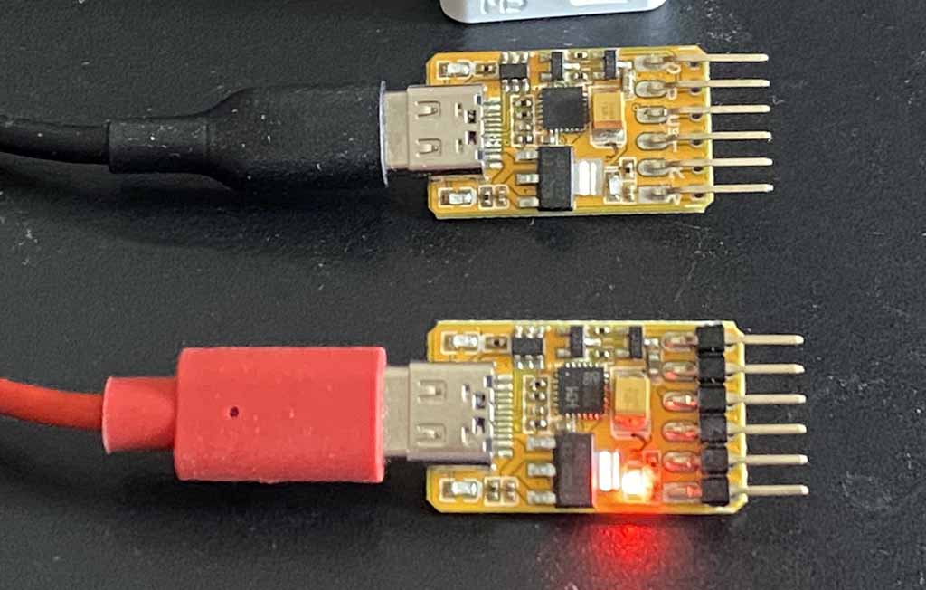

To the extent that the red power light does not come on, with one, but does come on with the other. Same with a LilyGO LilyGO T-Display S3. I use good quality USB C to USB C cables, the red one is BestBuy store brand and the black one DFRobot.<br />
It seems that the computer port driver is fussy about what it connects  to?</p>
<p dir="auto"><img src="/assets/uploads/files/1677346165221-1024-resized.jpg" alt="0_1677346163541_1024.jpg" class=" img-fluid img-markdown" /><br />
Red is USB DFRobot and black is BestBuy on Thunderbolt port</p>
