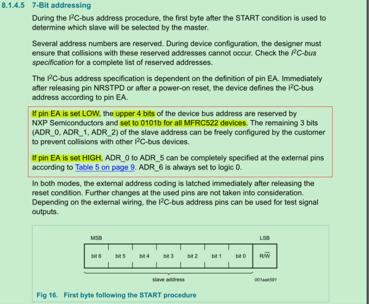

<p dir="auto">It can not be change the iic address. It has been defined by hardware of RFID module in RFID Unit.</p>
<p dir="auto">Here's the description about IIC address</p>

<p dir="auto">ah, so in this case, <a class="plugin-mentions-user plugin-mentions-a" href="/user/falmasi" aria-label="Profile: falmasi">@<bdi>falmasi</bdi></a> will need to use an i2c expander.<br />
Something like the TCA9548A to use multiple devices on one port.<br />
<a href="https://www.ebay.ca/itm/CJMCU-9548-TCA9548A-1-to-8-I2C-8-way-multi-channel-expansion-board-IIC-mod-P0I7-/182948898348?hash=item2a989aa62c&amp;_uhb=1" target="_blank" rel="noopener noreferrer nofollow ugc">link text</a><br />
New product idea for M5Stack?</p>
<p dir="auto"><img src="/assets/uploads/files/1547532220356-tim%E6%88%AA%E5%9B%BE20190115095742-resized.png" alt="0_1547532220523_TIM截图20190115095742.png" class=" img-fluid img-markdown" /></p>
