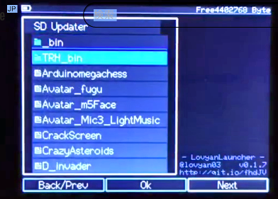

<p dir="auto">There is SD-Updater as a way to flash with .bin.</p>
<p dir="auto">lovyan03/M5Stack_LovyanLauncher<br />
Application startup by SD-Updater<br />
<a href="https://github.com/lovyan03/M5Stack_LovyanLauncher" target="_blank" rel="noopener noreferrer nofollow ugc">https://github.com/lovyan03/M5Stack_LovyanLauncher</a></p>
<p dir="auto">Youtube : M5Stack Lovyan Launcher - Ultimate Menu System<br />
<a href="https://www.youtube.com/watch?v=2MyFKLZKJ2A" target="_blank" rel="noopener noreferrer nofollow ugc">https://www.youtube.com/watch?v=2MyFKLZKJ2A</a><br />
<img src="/assets/uploads/files/1678922607281-lovyanlauncher.png" alt="0_1678922700273_LovyanLauncher.png" class=" img-fluid img-markdown" /></p>
