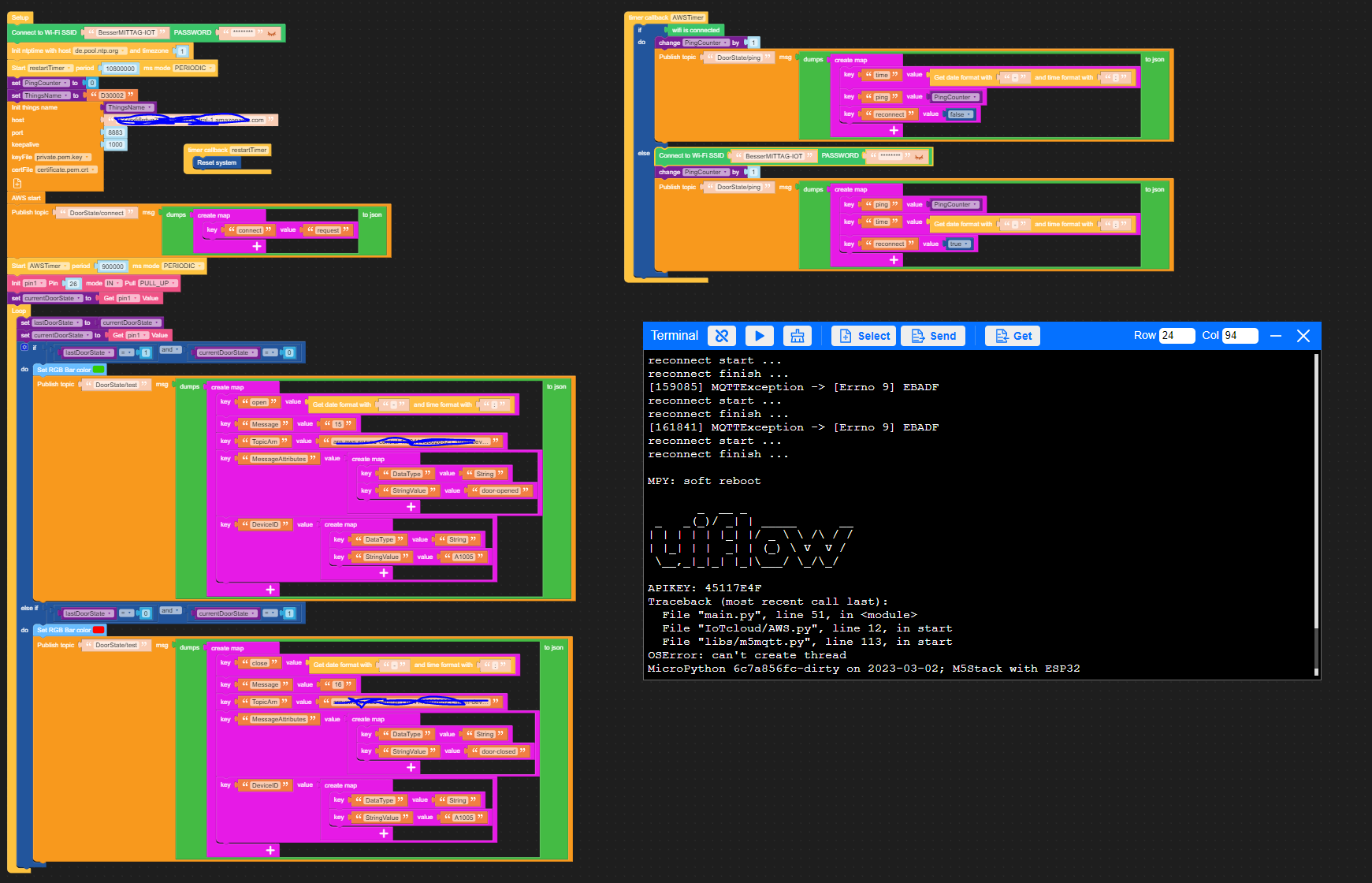

I am currently working on a System that needs to connect to AWS. Sadly i get the following Error messages when I Execute my code: <img src="/assets/uploads/files/1679405031282-support-resized.png" alt="0_1679405029035_Support.PNG" class=" img-fluid img-markdown" /></p>
<p dir="auto">I am using an ATOM Lite and UIFlow 1.11.3</p>

]]></description><link>https://community.m5stack.com/topic/5147/initiating-connection-to-aws</link><generator>RSS for Node</generator><lastBuildDate>Thu, 30 Apr 2026 15:16:57 GMT</lastBuildDate><atom:link href="https://community.m5stack.com/topic/5147.rss" rel="self" type="application/rss+xml"/><pubDate>Tue, 21 Mar 2023 13:25:39 GMT</pubDate><ttl>60</ttl><item><title><![CDATA[Reply to Initiating connection to AWS on Fri, 24 Mar 2023 16:42:00 GMT]]></title><description><![CDATA[<p dir="auto">Combination of error 09 (authentication acknowledgment error) and OS error shown in the command terminal</p>
]]></description><link>https://community.m5stack.com/post/20435</link><guid isPermaLink="true">https://community.m5stack.com/post/20435</guid><dc:creator><![CDATA[ajb2k3]]></dc:creator><pubDate>Fri, 24 Mar 2023 16:42:00 GMT</pubDate></item><item><title><![CDATA[Reply to Initiating connection to AWS on Fri, 24 Mar 2023 14:55:46 GMT]]></title><description><![CDATA[<p dir="auto">I tried restarting it, that didnt change anything.</p>
<p dir="auto"><a class="plugin-mentions-user plugin-mentions-a" href="/user/ajb2k3" aria-label="Profile: ajb2k3">@<bdi>ajb2k3</bdi></a> said in <a href="/post/20426">Initiating connection to AWS</a>:</p>
<p dir="auto">If I read correctly it means that the MQTT connection to AWS wasn't acknowledge which meant permission was refused.<br />
Have you restarted the ATOM or has AWS changed anything?<br />
Sorry, I haven't used AWS in a while</p>
<p dir="auto">Were did you read that the connection wasnt established?</p>

<p dir="auto">Here is my Pythoncode:</p>

<p dir="auto">I have set everything up in AWS, the connection was already established and worked fine.<br />
Do you mean a device shadow with digital twin? I dont see how that could resolve the issue.</p>

errors don't always apply to a specific line and also don't count empty lines.<br />
IIRC (and there's a possibility I don't as it was last year) have you set up the digital twin and permissions on AWS for the code to connect?</p>

]]></description><link>https://community.m5stack.com/post/20391</link><guid isPermaLink="true">https://community.m5stack.com/post/20391</guid><dc:creator><![CDATA[bmtd111]]></dc:creator><pubDate>Tue, 21 Mar 2023 15:14:50 GMT</pubDate></item></channel></rss>
