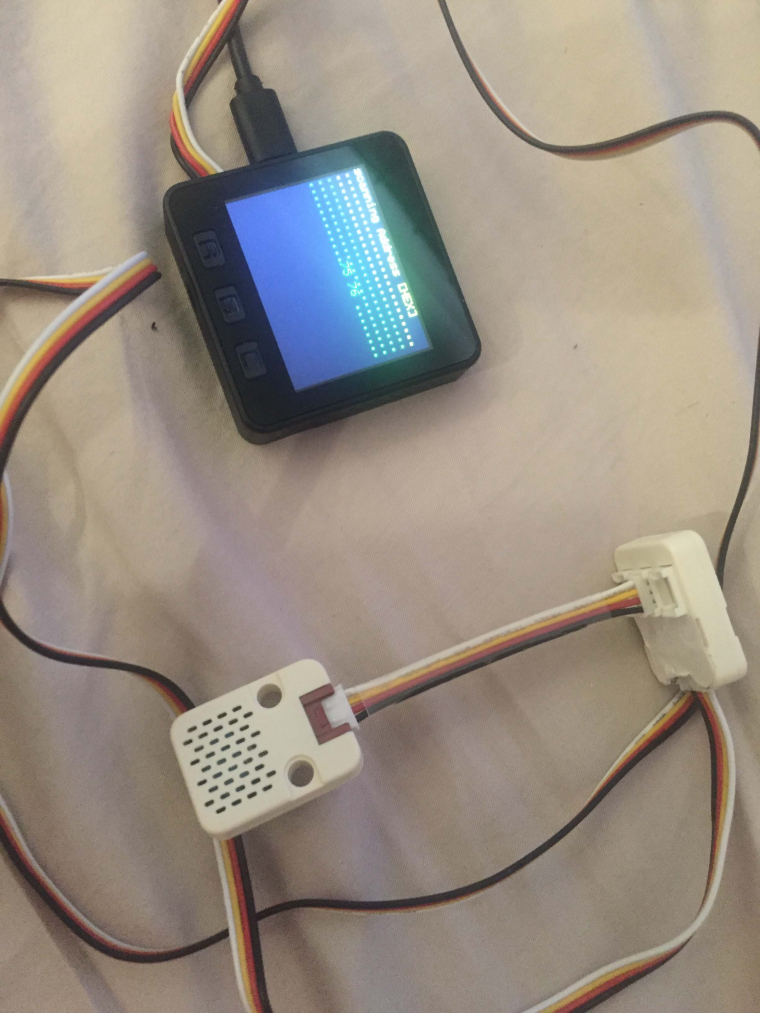

]]></description><link>https://community.m5stack.com/topic/517/grove-hub-unit-trouble</link><generator>RSS for Node</generator><lastBuildDate>Wed, 29 Apr 2026 06:21:35 GMT</lastBuildDate><atom:link href="https://community.m5stack.com/topic/517.rss" rel="self" type="application/rss+xml"/><pubDate>Fri, 18 Jan 2019 17:27:10 GMT</pubDate><ttl>60</ttl><item><title><![CDATA[Reply to Grove HUB unit trouble on Wed, 30 Jan 2019 08:05:05 GMT]]></title><description><![CDATA[<p dir="auto">I tested a hub device attached to port A with a few 100cm grove cables and I was able to successfully read the i2c address of the ENV sensor and also others. I tested with the i2c_tester arduino program <a href="https://github.com/m5stack/M5Stack/blob/master/examples/Advanced/I2C_Tester/I2C_Tester.ino" target="_blank" rel="noopener noreferrer nofollow ugc">https://github.com/m5stack/M5Stack/blob/master/examples/Advanced/I2C_Tester/I2C_Tester.ino</a> perhaps its just an isolated incident.<br />
<img src="/assets/uploads/files/1548835372478-wechatimg46-resized.jpg" alt="0_1548835367201_WechatIMG46.jpg" class=" img-fluid img-markdown" /></p>
]]></description><link>https://community.m5stack.com/post/2781</link><guid isPermaLink="true">https://community.m5stack.com/post/2781</guid><dc:creator><![CDATA[lukasmaximus]]></dc:creator><pubDate>Wed, 30 Jan 2019 08:05:05 GMT</pubDate></item><item><title><![CDATA[Reply to Grove HUB unit trouble on Tue, 29 Jan 2019 15:27:27 GMT]]></title><description><![CDATA[<p dir="auto">Also out of scientific curiosity, try wrapping the wires in some foil. It could be that the larger wire need to be shielded or the device may need its own power at that distance</p>

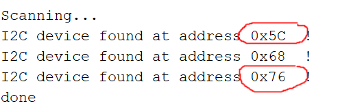

I discovered the cause of this problem with ENV unit<br />
It is long cable (50 cm) to HUB unit<br />
When I connected HUB unit with short cable to m5core - all I2C addresses was scanned successfully!<br />
<img src="/assets/uploads/files/1548318186817-f1c52e6a-0154-4c2f-a1f3-feb9900a442a-image.png" alt="0_1548318186295_f1c52e6a-0154-4c2f-a1f3-feb9900a442a-image.png" class=" img-fluid img-markdown" /></p>
<p dir="auto">Nice discovery</p>
]]></description><link>https://community.m5stack.com/post/2679</link><guid isPermaLink="true">https://community.m5stack.com/post/2679</guid><dc:creator><![CDATA[vvs551]]></dc:creator><pubDate>Thu, 24 Jan 2019 08:23:10 GMT</pubDate></item><item><title><![CDATA[Reply to Grove HUB unit trouble on Wed, 23 Jan 2019 12:31:08 GMT]]></title><description><![CDATA[<p dir="auto"><a class="plugin-mentions-user plugin-mentions-a" href="/user/vvs551" aria-label="Profile: vvs551">@<bdi>vvs551</bdi></a> If you wire the ENV module to the GROVE port A (with and without HUB) do you have the charging base connected?<br />
