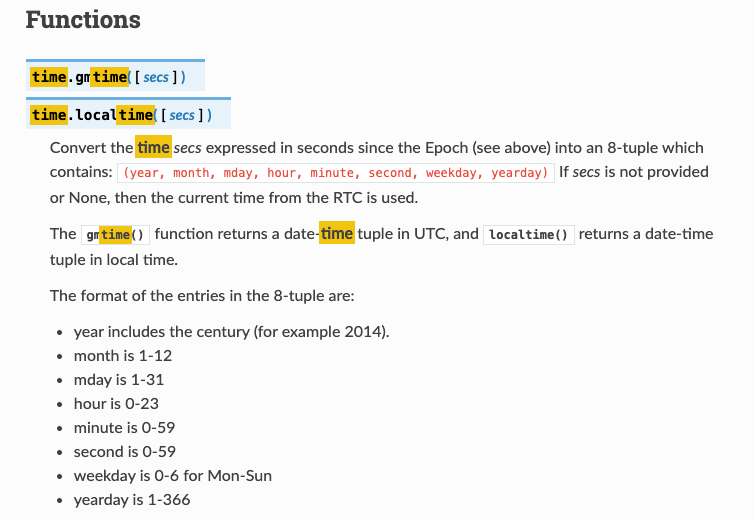

<p dir="auto">it seems that UIFlow (based on 1.19.1) doesn't take epoch into account, which is year 2000 in MP 1.19.1 or 1.20.</p>
<p dir="auto">Apart that there is confusion created on gmtime() and localtime() in UIFlow apis.</p>
<p dir="auto">Also to mention that in MP 1.20, the returned values from gmtime() and localtime() are not all time reliable (sometimes the ntpserver requested in MP localtime() return what in fact is gmtime()...)</p>

<p dir="auto">Hi, did you check this <a href="https://docs.micropython.org/en/latest/library/time.html?highlight=time#module-time" target="_blank" rel="noopener noreferrer nofollow ugc">time docs of micropython port</a>?</p>
<p dir="auto"><img src="/assets/uploads/files/1686542086324-1cceab94-6e76-4b26-8dd3-5423f8a76b5f-image.png" alt="0_1686542095863_1cceab94-6e76-4b26-8dd3-5423f8a76b5f-image.png" class=" img-fluid img-markdown" /></p>
<p dir="auto"><img src="/assets/uploads/files/1686542102678-c742a3f5-e76c-46bb-8f83-82baab888585-image.png" alt="0_1686542112272_c742a3f5-e76c-46bb-8f83-82baab888585-image.png" class=" img-fluid img-markdown" /></p>
