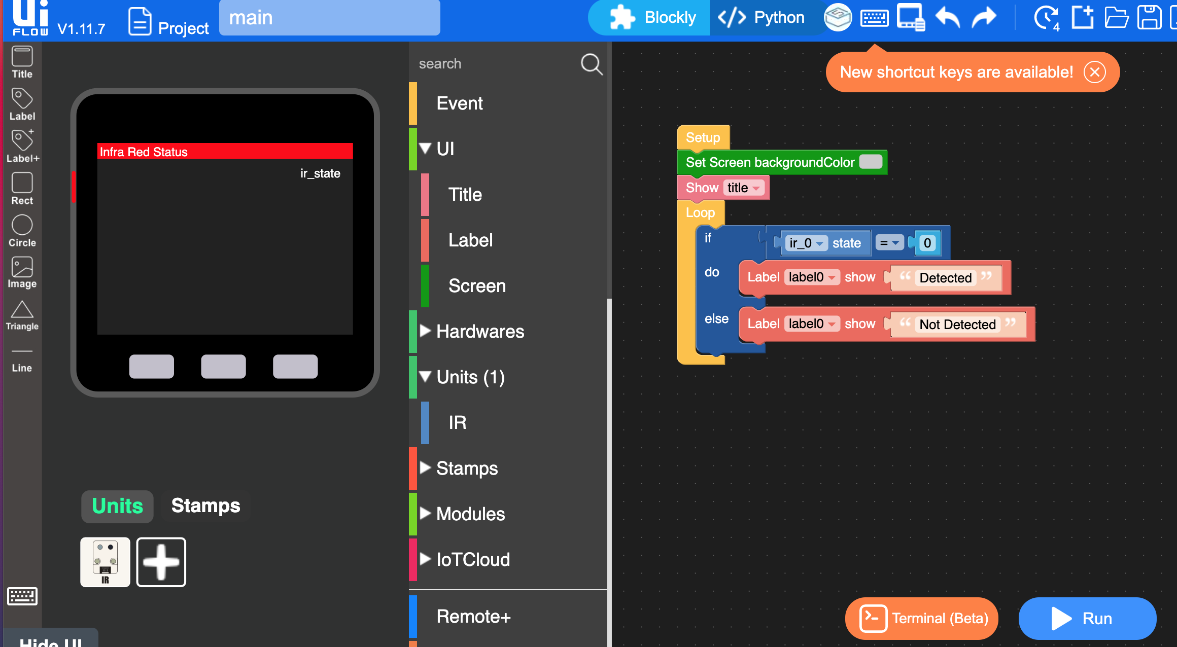

I have an M5GO, pretty simple I am testing the IR module like so</p>
<p dir="auto"><img src="/assets/uploads/files/1683384878182-25d89409-e7b0-4493-9e4c-d4d5fddb419e-image-resized.png" alt="0_1683384877466_25d89409-e7b0-4493-9e4c-d4d5fddb419e-image.png" class=" img-fluid img-markdown" /></p>
<p dir="auto">When I run, I get this red error:</p>
<p dir="auto">'IR_NEC' object has no attribute 'rxStatus'.</p>
<p dir="auto">I don't know what else to debug.</p>

<p dir="auto">the IR unit has two modes: <code>NEC</code> and <code>GPIO</code>. By default the IR unit is added in <code>NEC</code> mode, however the block <code>ir_0 state</code> is part of the <code>GPIO</code> mode - hence the error.</p>
<p dir="auto">Try switching the mode to <code>GPIO</code> by clicking on the IR unit and then use the <code>Mode</code> drop-down menu.</p>
