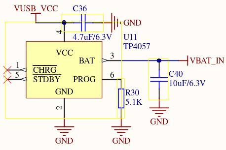

<p dir="auto">AFAIK <code>power.isCharging()</code> is a function from M5Stack devices (Base, Fire, etc.) which use a power management chip (IP5306) which allows to read this information via software (I2C).</p>
<p dir="auto">In Timer Camera F a different solution is used to charge the battery which doesn't have I2C and therefore doesn't allow to check whether the battery is being charged via software.</p>
<p dir="auto">As you can see from below picture (taken from this <a href="https://m5stack.oss-cn-shenzhen.aliyuncs.com/resource/docs/schematic/TimerCAM/TimerCAM_A2-PMS_UART.pdf" target="_blank" rel="noopener noreferrer nofollow ugc">schematic</a>), the charger IC doesn't have I2C and also the CHRG pin is not connected to anything.</p>
<p dir="auto"><img src="/assets/uploads/files/1684396851088-m5stacktimercamfbatcharger20230518.png" alt="0_1684396853931_M5StackTimerCamFBatCharger20230518.png" class=" img-fluid img-markdown" /></p>
<p dir="auto">I see two possibilities:</p>
<ul>
<li>you could try to read the battery voltage via ADC as there is a connection from the battery through a voltage divider to GPIO38. However it will be difficult to determine from that whether the battery is actually being charged or not.</li>
<li>you could modify the hardware and connect the CHRG output to a free GPIO of the ESP32.</li>
</ul>
