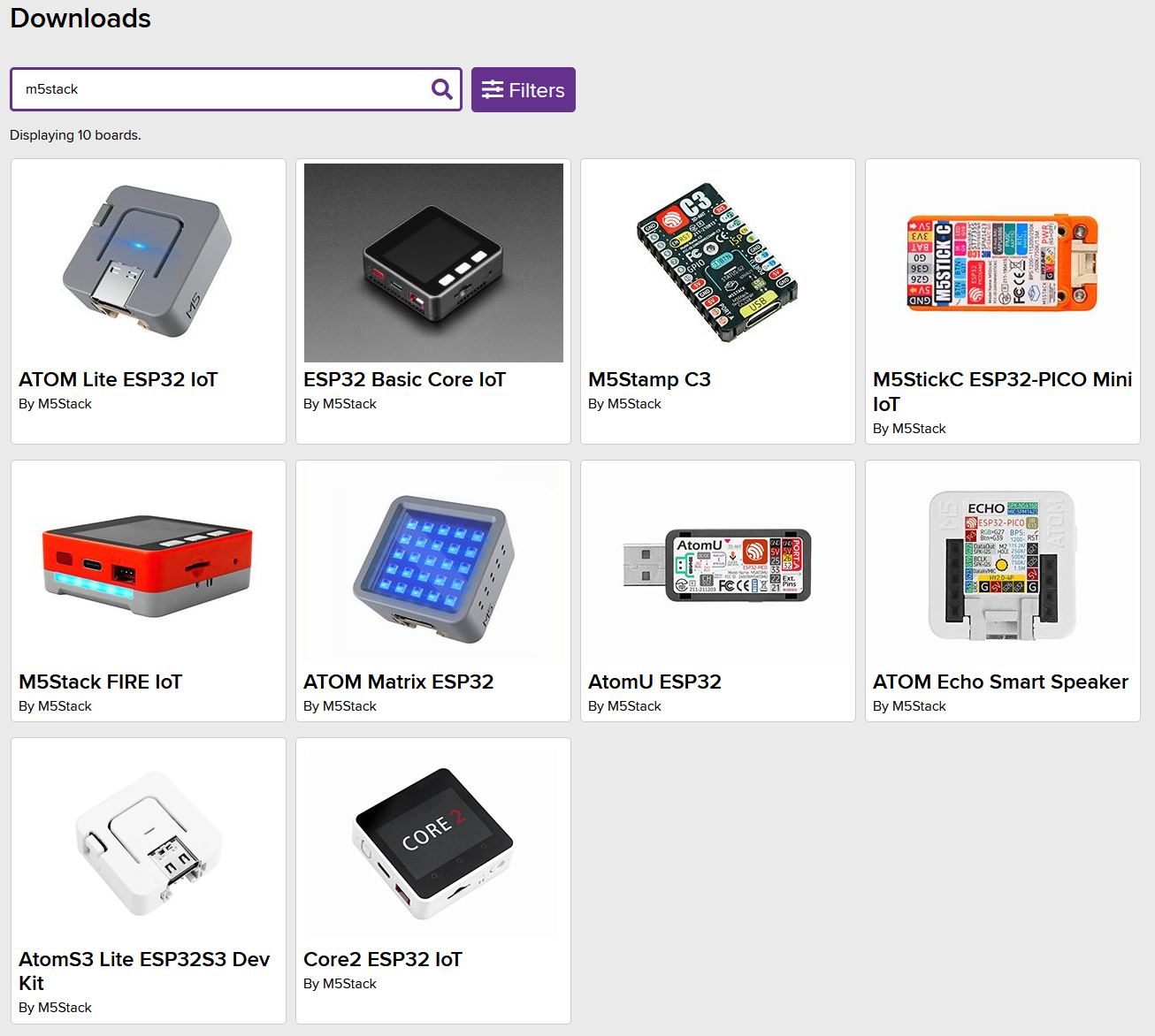

<?xml version="1.0" encoding="UTF-8"?><rss xmlns:dc="http://purl.org/dc/elements/1.1/" xmlns:content="http://purl.org/rss/1.0/modules/content/" xmlns:atom="http://www.w3.org/2005/Atom" version="2.0"><channel><title><![CDATA[Circuitpython for M5Stack devices is here!!]]></title><description><![CDATA[<p dir="auto">I made the Circuitpython porting for several M5Stack devices:<br />
Go to the <a href="https://circuitpython.org/downloads?q=m5stack" target="_blank" rel="noopener noreferrer nofollow ugc">Circuitpython download</a> page and burn the firmaware directly from your browser</p>
<p dir="auto"><img src="/assets/uploads/files/1684598354876-cd59c3c7-94d6-474a-8899-de3a4d610eff-image-resized.png" alt="0_1684598345360_cd59c3c7-94d6-474a-8899-de3a4d610eff-image.png" class=" img-fluid img-markdown" /></p>
<p dir="auto">I have made all ports excepts the M5Stamp C3. More are coming!!</p>
