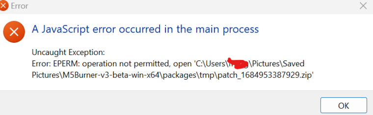

I see an uncaught exception eperm acces not permitted... I was not knowing what to do and as windows see the sofzware as a threat...
a javascript error has occured
@DR_Froggy_rD It says you to open the file from the address shown.

ok but the file tmp is empty.

I got the way around the problem of security but still the tmp file is empty so it cannot access the patch because there are no files there
I was able to run the m5 burner as admin ( right click on the icone m5).... so this must go through the windows issue although the file is empty.this still be an issue.
the zip file is not inside the folder.....
Why is it looking in the pictures folder?
M5Burner should be in the root user folder or the programs folder! -
Because it put the downloaded zipfile in here and extracted here...
As it is not a msi installer but just an exe i had never a problem running an exe not from the program files folder. Also from the temp folder.
It is not playing a role sofar. This would be for me the first time.... if this is mandatory one must write a step by step standard procedure as idiot proof as possible...
Nevertheless i an sure trying to extract into the program file folder will not solve the missing patch file...my honest opinion. -

Hi Adam, so: I unzip my file in programm subfolder.
open M5nurner .exe as administrator.I can update firmware list.... but still looking for the same patch in the unzipped folder: I have anotherjavascript error message:: It is not EPERM but ENOENT..

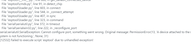

However I connected the s3 to it. and push the left side button until green led flashes....then connect com6 (the detected port com there it is green) It fails to erase or to burn. failed to get mac. also when reducing the baud rate to 11000..
I tried even the easyloader software without success...
