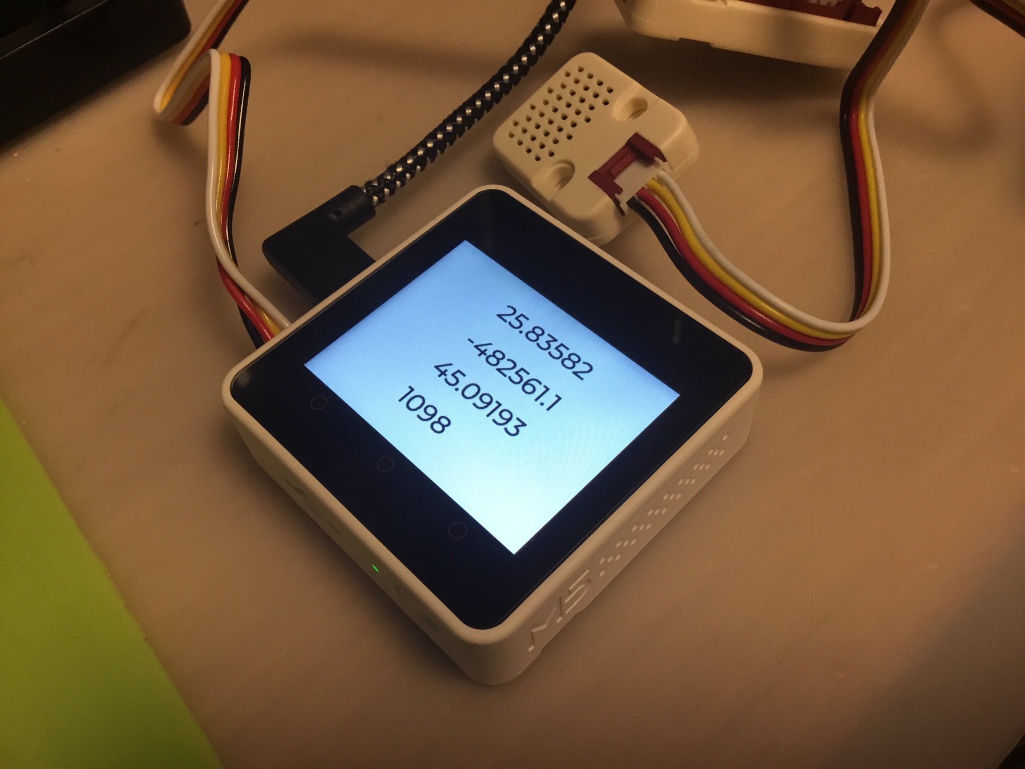

I can't get the correct value of pressure from the sensors with PA.HUB 2 Unit. I can get the correct value from the sensors directly connecting with the M5 Stack Core 2.<br />
<img src="https://pbs.twimg.com/media/FzCoiHCakAAW3VQ?format=jpg&amp;name=large" alt="alt text" class=" img-fluid img-markdown" /></p>
<p dir="auto">Then, I wonder if "Pa.HUB UNIT" and "Pa.HUB 2 UNIT" are different in IU Flow? However, I can't find "Pa.HUB 2 UNIT" in the UNITS palette.</p>
]]></description><link>https://community.m5stack.com/topic/5399/pa-hub-2-unit-can-t-work-right-for-env-iii-and-or-mini-bps-unit-by-ui-flow-with-web-edition</link><generator>RSS for Node</generator><lastBuildDate>Wed, 29 Apr 2026 08:45:14 GMT</lastBuildDate><atom:link href="https://community.m5stack.com/topic/5399.rss" rel="self" type="application/rss+xml"/><pubDate>Tue, 20 Jun 2023 09:54:10 GMT</pubDate><ttl>60</ttl><item><title><![CDATA[Reply to &quot;PA.HUB 2 Unit&quot; can&#x27;t work right for ENV III and&#x2F;or Mini BPS Unit by UI Flow with web edition. on Mon, 21 Aug 2023 07:32:38 GMT]]></title><description><![CDATA[<p dir="auto"><a class="plugin-mentions-user plugin-mentions-a" href="/user/digiponta" aria-label="Profile: digiponta">@<bdi>digiponta</bdi></a> Hi, when ENV III and PAHUB are used at the same time, it may not work, because the default I2C address of PAHUB is the same as of QMP6988 barometer inside ENVIII, you can avoid this problem by changing the I2C address of PAHUB or QMP6988</p>
