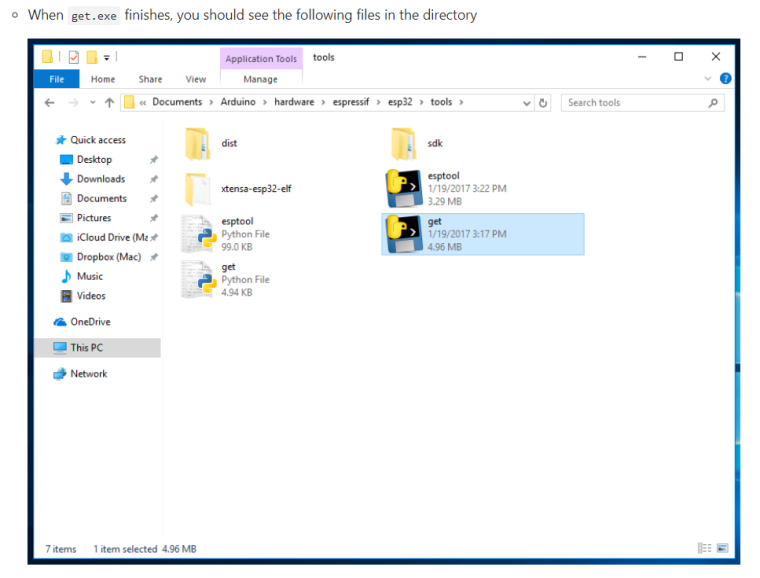

<p dir="auto">If not , you need to re-install the driver - make sure Python is on your Windows path. You can verify the path is working by opening command prompt and typing - python.</p>
<p dir="auto">Are these files (below) available after you have Python installed and after you run get.exe ? They should be.</p>
<p dir="auto"><img src="/assets/uploads/files/1517497917998-b38be06f-ed2b-41d4-8a75-15e3897fa55b-image-resized.png" alt="0_1517497909581_b38be06f-ed2b-41d4-8a75-15e3897fa55b-image.png" class=" img-fluid img-markdown" /></p>
