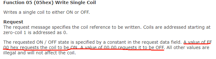

]]></description><link>https://community.m5stack.com/topic/5401/modbus-master-crashes-and-missing-documentation</link><generator>RSS for Node</generator><lastBuildDate>Tue, 28 Apr 2026 23:52:33 GMT</lastBuildDate><atom:link href="https://community.m5stack.com/topic/5401.rss" rel="self" type="application/rss+xml"/><pubDate>Tue, 20 Jun 2023 22:17:10 GMT</pubDate><ttl>60</ttl><item><title><![CDATA[Reply to Modbus Master crashes and missing documentation on Thu, 06 Jul 2023 07:45:17 GMT]]></title><description><![CDATA[<p dir="auto">Hi, <a class="plugin-mentions-user plugin-mentions-a" href="/user/insanelx" aria-label="Profile: insaneLX">@<bdi>insaneLX</bdi></a> <img src="/assets/uploads/files/1688369012974-5545b634-1765-460d-a5c1-c3d1ae46fd74-image.png" alt="0_1688369025206_5545b634-1765-460d-a5c1-c3d1ae46fd74-image.png" class=" img-fluid img-markdown" /><br />
0xff00(ON or 1) and 0x00(OFF or 0)</p>
