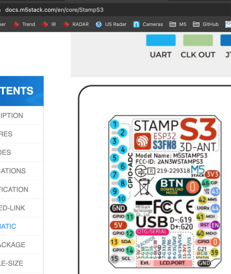

<?xml version="1.0" encoding="UTF-8"?><rss xmlns:dc="http://purl.org/dc/elements/1.1/" xmlns:content="http://purl.org/rss/1.0/modules/content/" xmlns:atom="http://www.w3.org/2005/Atom" version="2.0"><channel><title><![CDATA[StampS3 - How to get into boot loader mode]]></title><description><![CDATA[<p dir="auto">This great board does not have the usual buttons.<br />
Does anyone know how to switch it into boot loader mode?</p>
]]></description><link>https://community.m5stack.com/topic/5405/stamps3-how-to-get-into-boot-loader-mode</link><generator>RSS for Node</generator><lastBuildDate>Wed, 29 Apr 2026 11:29:55 GMT</lastBuildDate><atom:link href="https://community.m5stack.com/topic/5405.rss" rel="self" type="application/rss+xml"/><pubDate>Wed, 21 Jun 2023 14:22:53 GMT</pubDate><ttl>60</ttl><item><title><![CDATA[Reply to StampS3 - How to get into boot loader mode on Thu, 30 Jan 2025 13:39:23 GMT]]></title><description><![CDATA[<p dir="auto">The button is under the label, try to press carefully and you should feel the click.</p>
<p dir="auto">Disconnect the device, press and hold the button, connect your device and release the button.</p>
<p dir="auto">The documentation has a short vidio showing the button without the label.</p>
<p dir="auto">This is the same for M5dial which has the S3stamp too.</p>

]]></description><link>https://community.m5stack.com/post/21261</link><guid isPermaLink="true">https://community.m5stack.com/post/21261</guid><dc:creator><![CDATA[Terrence7]]></dc:creator><pubDate>Thu, 22 Jun 2023 01:38:22 GMT</pubDate></item><item><title><![CDATA[Reply to StampS3 - How to get into boot loader mode on Wed, 21 Jun 2023 22:39:59 GMT]]></title><description><![CDATA[<p dir="auto"><a class="plugin-mentions-user plugin-mentions-a" href="/user/terrence7" aria-label="Profile: terrence7">@<bdi>terrence7</bdi></a><img src="/assets/uploads/files/1687387053352-push-the-button-resized.png" alt="0_1687387060784_Push The Button.png" class=" img-fluid img-markdown" /> image url)<br />
BTN download mode 0</p>
]]></description><link>https://community.m5stack.com/post/21260</link><guid isPermaLink="true">https://community.m5stack.com/post/21260</guid><dc:creator><![CDATA[teastain]]></dc:creator><pubDate>Wed, 21 Jun 2023 22:39:59 GMT</pubDate></item><item><title><![CDATA[Reply to StampS3 - How to get into boot loader mode on Wed, 21 Jun 2023 21:16:49 GMT]]></title><description><![CDATA[<p dir="auto"><a class="plugin-mentions-user plugin-mentions-a" href="/user/ajb2k3" aria-label="Profile: ajb2k3">@<bdi>ajb2k3</bdi></a> I have read this page and everything else I can find on the internet.</p>
