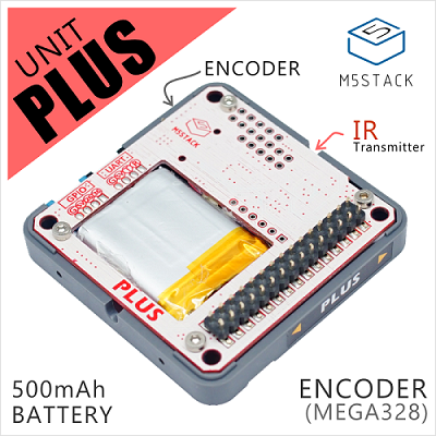

<?xml version="1.0" encoding="UTF-8"?><rss xmlns:dc="http://purl.org/dc/elements/1.1/" xmlns:content="http://purl.org/rss/1.0/modules/content/" xmlns:atom="http://www.w3.org/2005/Atom" version="2.0"><channel><title><![CDATA[PLUS Module problem about PORTB and PORTC]]></title><description><![CDATA[<p dir="auto">PORTB(GPIO) and PORTC(UART) of the PLUS Module looks like that both the color of the connector and the silk printing are reversed.<br />
<img src="/assets/uploads/files/1548500427216-plus.jpg" alt="0_1548500425337_PLUS.jpg" class=" img-fluid img-markdown" /></p>

I have checked it. My PLUS is same as yours.</p>
<p dir="auto">The picture from docs is wrong.</p>
<p dir="auto"><img src="/assets/uploads/files/1553998113632-module_plus_01.png" alt="0_1553998103067_module_plus_01.png" class=" img-fluid img-markdown" /></p>
]]></description><link>https://community.m5stack.com/post/3457</link><guid isPermaLink="true">https://community.m5stack.com/post/3457</guid><dc:creator><![CDATA[m5-docs]]></dc:creator><pubDate>Sun, 31 Mar 2019 02:08:41 GMT</pubDate></item><item><title><![CDATA[Reply to PLUS Module problem about PORTB and PORTC on Fri, 29 Mar 2019 13:15:32 GMT]]></title><description><![CDATA[<p dir="auto">Please check your PLUS.<br />
