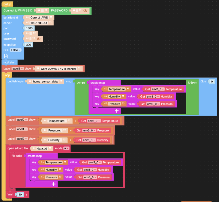

This is the code I'm using on a core2 that sends to a self hosted Mosquitto server and so far had no issues.</p>
<p dir="auto"><img src="/assets/uploads/files/1688014874722-screenshot-2023-06-29-at-06.01.10-resized.png" alt="0_1688014882686_Screenshot 2023-06-29 at 06.01.10.png" class=" img-fluid img-markdown" /></p>

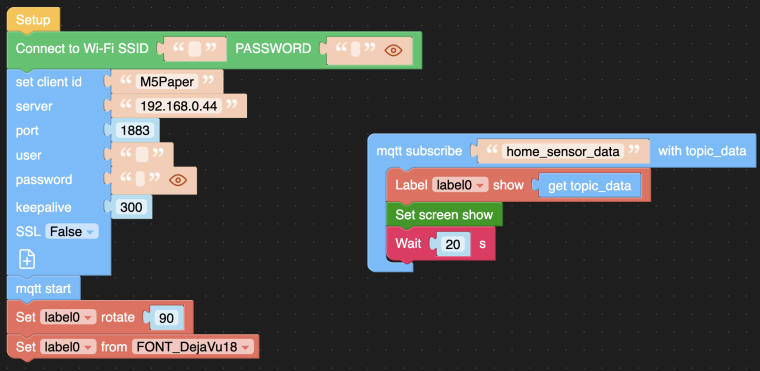

<p dir="auto">and this is my M5Paper receiver code that retrieves data from the server.</p>
]]></description><link>https://community.m5stack.com/post/21376</link><guid isPermaLink="true">https://community.m5stack.com/post/21376</guid><dc:creator><![CDATA[ajb2k3]]></dc:creator><pubDate>Thu, 29 Jun 2023 05:02:14 GMT</pubDate></item><item><title><![CDATA[Reply to Unable to subscribe to IoT topic (M5StickCPlus) on Thu, 29 Jun 2023 01:05:53 GMT]]></title><description><![CDATA[<p dir="auto"><a class="plugin-mentions-user plugin-mentions-a" href="/user/ajb2k3" aria-label="Profile: ajb2k3">@<bdi>ajb2k3</bdi></a></p>

<p dir="auto"><img src="https://i.imgur.com/liSIf8A.png" alt="alt text" class=" img-fluid img-markdown" /></p>
<p dir="auto">thanks for your help.</p>
