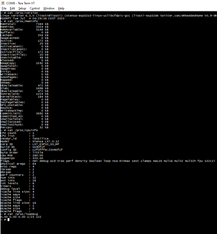

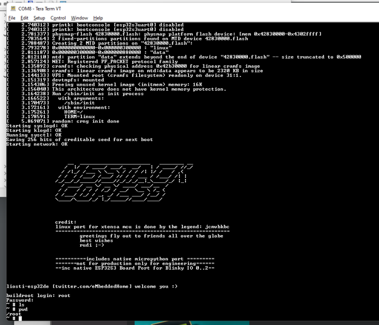

<img src="/assets/uploads/files/1689064547152-cores3_linux-resized.png" alt="0_1689064557067_cores3_linux.png" class=" img-fluid img-markdown" /></p>
<p dir="auto"><img src="/assets/uploads/files/1689066431772-cores3-linux-ss2-resized.png" alt="0_1689066441616_cores3 linux ss2.png" class=" img-fluid img-markdown" /></p>
]]></description><link>https://community.m5stack.com/post/21543</link><guid isPermaLink="true">https://community.m5stack.com/post/21543</guid><dc:creator><![CDATA[mtylerjr]]></dc:creator><pubDate>Tue, 11 Jul 2023 09:07:19 GMT</pubDate></item></channel></rss>
