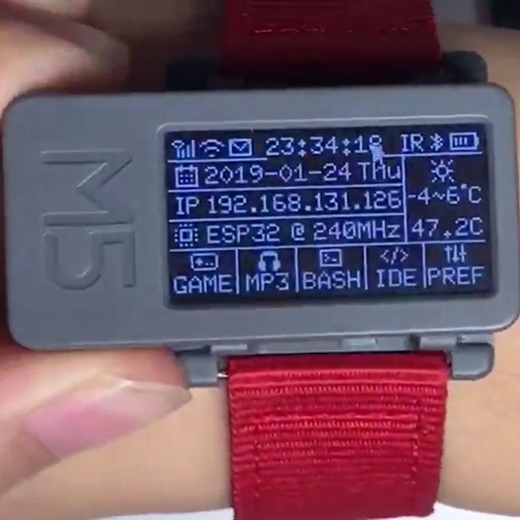

<?xml version="1.0" encoding="UTF-8"?><rss xmlns:dc="http://purl.org/dc/elements/1.1/" xmlns:content="http://purl.org/rss/1.0/modules/content/" xmlns:atom="http://www.w3.org/2005/Atom" version="2.0"><channel><title><![CDATA[M5Stick Watch]]></title><description><![CDATA[<p dir="auto">Very smart M5Stick Watch application, Excellent UI layout ! This one is created by a Chinese maker !!<br />
Youtube:        <a href="https://www.youtube.com/watch?v=kw5ut5MAkZw" target="_blank" rel="noopener noreferrer nofollow ugc">https://www.youtube.com/watch?v=kw5ut5MAkZw</a><br />
Youku:        <a href="https://v.youku.com/v_show/id_XNDAzMjE0ODY0NA==.html?spm=a2h3j.8428770.3416059.1" target="_blank" rel="noopener noreferrer nofollow ugc">https://v.youku.com/v_show/id_XNDAzMjE0ODY0NA==.html?spm=a2h3j.8428770.3416059.1</a></p>
<p dir="auto"><img src="/assets/uploads/files/1548575871042-o7ky9nuhbdbb12r7tzkbllshzwenbqoq-resized.jpg" alt="0_1548575869719_o7kY9nUHbDBB12r7TZkbllshZweNBQOq.jpg" class=" img-fluid img-markdown" /></p>

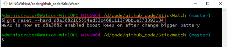

Just open Git bash in the project directory, enter <code>git reset --hard d8a3682105554ed53c468111379bb1e573392134</code></p>
<p dir="auto"><img src="/assets/uploads/files/1551081838512-roll-back-resized.png" alt="0_1551081838926_roll back.png" class=" img-fluid img-markdown" /></p>
<p dir="auto">Then it has rolled back. Open .ino file and compile it.</p>

<p dir="auto">You can rollback the software version using this command "git reset --hard d8a3682105554ed53c468111379bb1e573392134"</p>

<p dir="auto">The code</p>
<p dir="auto"><a href="https://github.com/m5stack/StickWatch" target="_blank" rel="noopener noreferrer nofollow ugc">https://github.com/m5stack/StickWatch</a></p>
<p dir="auto">doesn't compile for me...</p>
<p dir="auto">this is the arduino 1.8.7 output:<br />
Sketch uses 1929074 bytes (147%) of program storage space. Maximum is 1310720 bytes.</p>
<p dir="auto">Global variables use 65064 bytes (19%) of dynamic memory, leaving 262616 bytes for local variables. Maximum is 327680 bytes.<br />
Sketch too big; see <a href="http://www.arduino.cc/en/Guide/Troubleshooting#size" target="_blank" rel="noopener noreferrer nofollow ugc">http://www.arduino.cc/en/Guide/Troubleshooting#size</a> for tips on reducing it.<br />
Error compiling for board M5Stack-Core-ESP32.</p>
