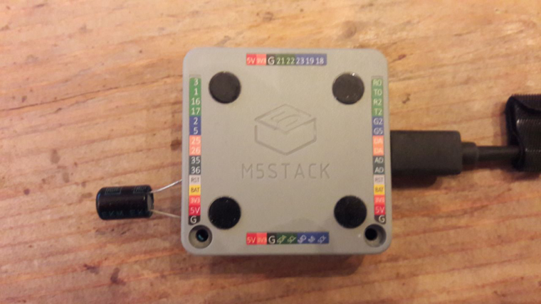

      I tried reversing the cap, It still won't connect. It still has the same timeout problem. Changing baud rate doesn't help either.

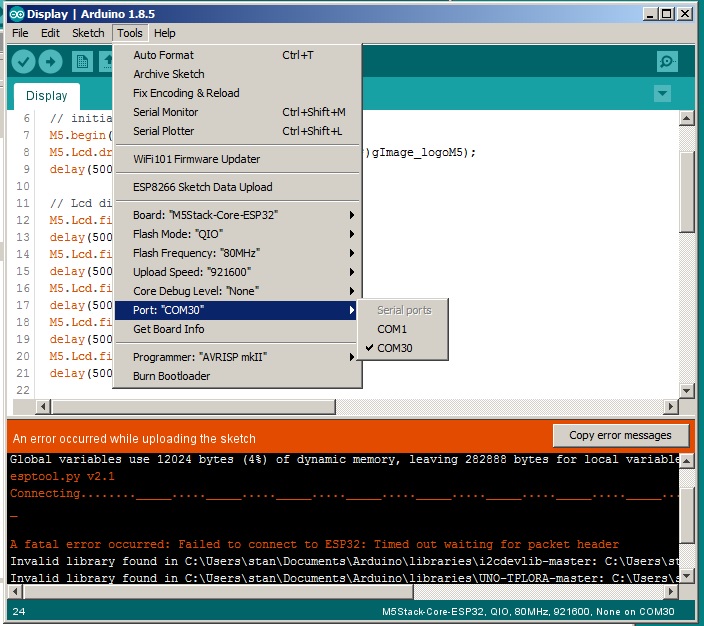

          I am using win7 and arduino ide 1.8.5. The board automatically selects the com port when plugged in . The port varies .
          I have the cap soldered onto dupont leads and have them plugged all the way in. I tried both polarity's
          I keep getting the "timed out waiting for packet header " error. for whatever reason it won't connect. I have no problems with the ports with various Arduino boards, ESP8266's and ESP32's

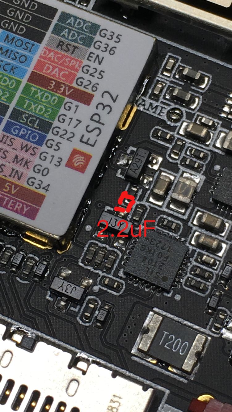

                                  Hi guys, just got mine in today and it kept resetting while trying to program. Started at the forums and found this post.
                                  As a R&D engineer let me first just say the guys at m5Stack know what they are doing on the hardware side. It's an exceptions build, But looking at the schematic, i am kinda shocked they dont have a cap on the reset line.
                                  I tried 3 values and all worked. 0.1uf, 2.2uf & 10uf. Would not go higher than 10uf though.
                                  I stuck a 0.1uf cap on the reset pin to gnd, and mine works just fine now, Typically in this circuit anything =<10uf should work just fine.
                                  In the photo I put a 0805 cap, there. It would be best to stick a 0603 there but I didn't have any.
                                  You can get these locally at mouser or digikey.
                                  0.1uf cap at Mouser
                                  For those of you who dont have solder skills like this you can use a through hole cap like this one externally on the box from "RST" to "G". polarity does not matter for this ceramic cap.
                                  0.1uf Through Hole Cap

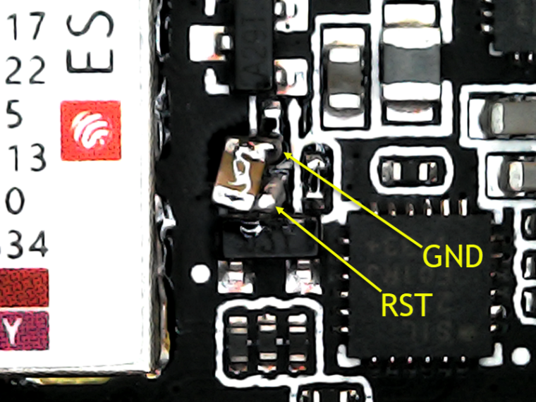

                                      A 100nF SMD capacitor soldered between EN (the collector of VT2) and the shield of the ESP32 module did the job for me.
                                      100nF between EN collector and GND
                                      Serge — http://hamwaves.com/iot/

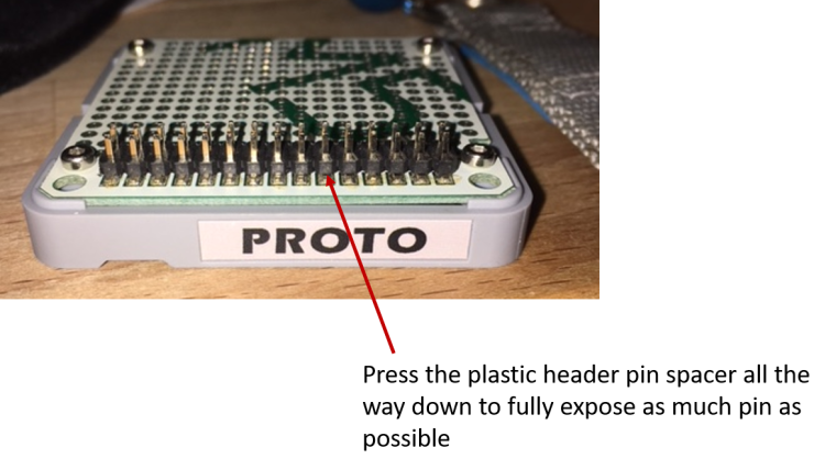

                                        As a heads up - I was having the same bang your head against the wall problem as Stanszal trying to get the "temporary" capacitor fix to work. Turns out that in addition to the capacitor being needed, there may be issues with the header connections on some of the boards. None of the GND\RESET connections worked with the capacitor thru the bottom plate. Pulled the bottom plate and plugged the cap right into the MBus header GND\RST on the system board and it's worked every time - plan is to solder the CAP patch once I get a small one.
                                        So - besides the capacitor issue (I really hope the fabricator reads this stuff and comes up with a fix), you all need to be aware as to why soldered boards are much preferred over solderless breadboards and header stacks. Less likely to have poor connections via solder. I love the compactness and modularity of the M5Stack (part of why I picked one up to play with) but this just underscores that you need to be wary of the header pin connections on the modules. The short pins and sockets and tight tolerances to make this what it is looks prone to connection problems.
                                        • K Offline
                                          KenTinker
                                          Messed around with the M5Stack again a bit this morning. One thing that seemed to help the pin connections between the bottom plate and MBus socket was to work across the plastic pin guides and press it down closer to the base plate board. I'd done a few more sketches to upload with the capacitor plugged into the MBus socket. When I put things back together, I couldn't get it to power on with the base plate so I tried pressing the header pin plastic spacer down to make sure I had better contact into the MBus socket. This fixed the battery power problem AND has (at least short term) allowed me to use the external temporary capacitor via the baseplate sockets and pins. Suspect it explains Stanszal's similar problem and why some other have reported the external capacitor approach not working after a while. I am going to have to keep in mind that the M5Bus header and mating pins have a very finite insertion life and to try and be sure I seat things well if I use proto-, battery-, etc., expansion boards.
