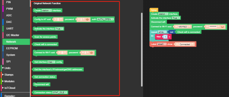

]]></description><link>https://community.m5stack.com/post/21752</link><guid isPermaLink="true">https://community.m5stack.com/post/21752</guid><dc:creator><![CDATA[csierra67]]></dc:creator><pubDate>Tue, 01 Aug 2023 20:56:51 GMT</pubDate></item><item><title><![CDATA[Reply to Compilation error for a project using SD card on Mon, 31 Jul 2023 02:53:02 GMT]]></title><description><![CDATA[<p dir="auto">Hi, If using download mode, Wi-Fi configuration is required first<br />
<img src="/assets/uploads/files/1690771913518-13e1fb39-fee5-450d-8e41-1dd87c619fa5-image-resized.png" alt="0_1690771927690_13e1fb39-fee5-450d-8e41-1dd87c619fa5-image.png" class=" img-fluid img-markdown" /></p>

Worked after I made this change.</p>
]]></description><link>https://community.m5stack.com/post/21694</link><guid isPermaLink="true">https://community.m5stack.com/post/21694</guid><dc:creator><![CDATA[csierra67]]></dc:creator><pubDate>Wed, 26 Jul 2023 10:01:10 GMT</pubDate></item><item><title><![CDATA[Reply to Compilation error for a project using SD card on Wed, 26 Jul 2023 03:10:23 GMT]]></title><description><![CDATA[<p dir="auto">Hi, Checked, and it works fine, can you check the SD card or are you using an internet-based block like NTP?</p>
