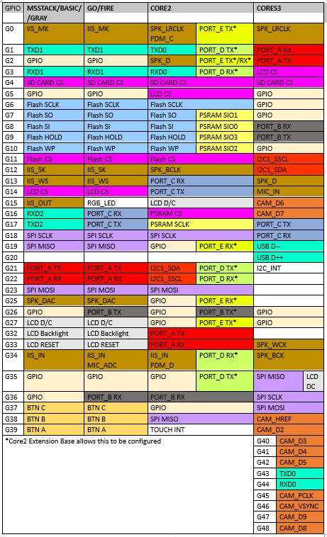

<img src="/assets/uploads/files/1692833136662-0d799851-8148-4c95-b152-b9ba21da80a9-image.png" alt="0_1692833152142_0d799851-8148-4c95-b152-b9ba21da80a9-image.png" class=" img-fluid img-markdown" /><br />
Several question marks remain though.</p>
]]></description><link>https://community.m5stack.com/post/21757</link><guid isPermaLink="true">https://community.m5stack.com/post/21757</guid><dc:creator><![CDATA[mtylerjr]]></dc:creator><pubDate>Wed, 23 Aug 2023 23:25:39 GMT</pubDate></item></channel></rss>
