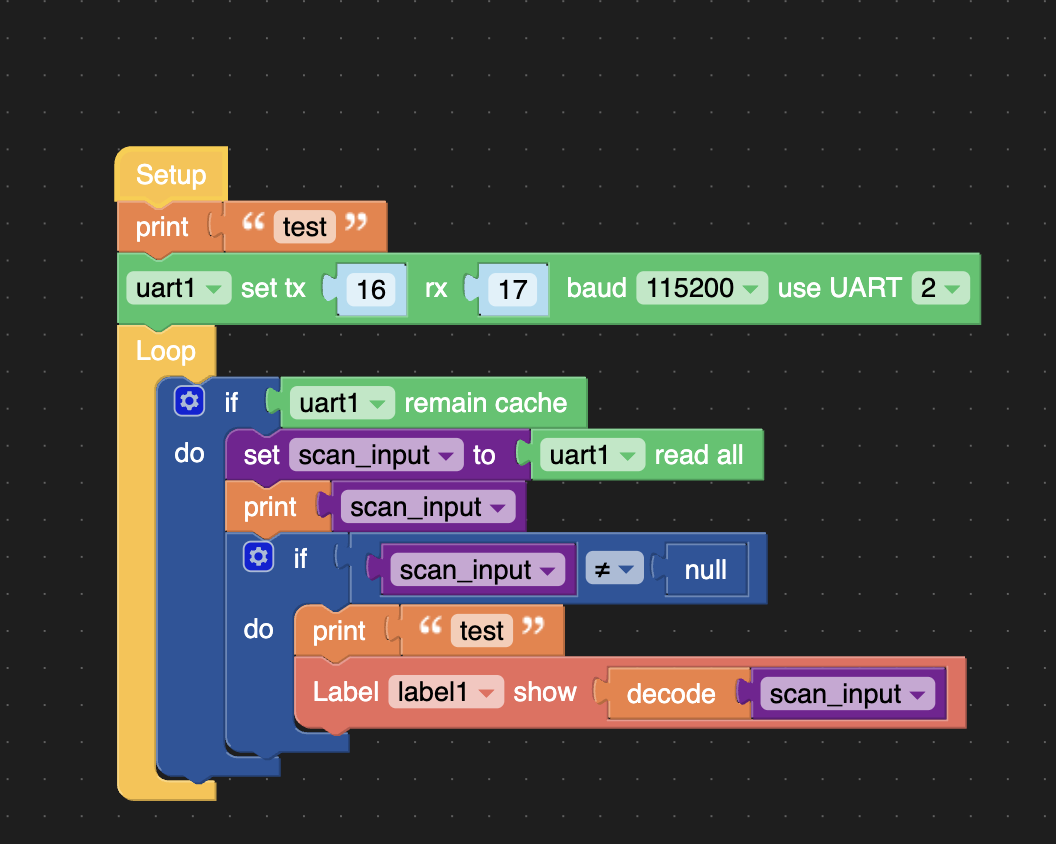

I got an M5Fire and a QR-Code Scanner with the Atom Lite. I want to send the results of the QR scanner to the M5Fire via UART, and I connect them with a Grove cable via Port C on the M5Fire (which I bought last week).</p>
<p dir="auto">I can make it work, BUT</p>
<ol>
<li>it only works when I download it via UIFLOW, I can not test it live from UIFlow, because then it runs into an error</li>
<li>The setup to make it work is different from what I would expect (Tx and Rx have to be switched).</li>
</ol>
<p dir="auto">You can see the screenshot attached, which makes it work:<br />
<img src="/assets/uploads/files/1691766789006-bildschirm-foto-2023-08-11-um-17.12.07-resized.png" alt="0_1691766799945_Bildschirm­foto 2023-08-11 um 17.12.07.png" class=" img-fluid img-markdown" /></p>
<p dir="auto">If I run it "live", I get the following error though:<br />
Guru Meditation Error: Core  1 panic'ed (LoadProhibited). Exception was unhandled.</p>
<p dir="auto">Which I saw being attributed to the pins being used otherwise.</p>
<p dir="auto">Can anyone help me shed some light on that?</p>

<p dir="auto">the first M5Stack device, M5Stack Basic, came w/o PSRAM, so using GPIO16 and GPIO17 for UART was an ok, albeit unlucky, choice.</p>
<p dir="auto">Note: most functions (I2C, UART, etc.) can be assigned to almost any GPIOs. Unfortunately PSRAM is an exception and requires GPIO16 and GPIO17 to be used.</p>
<p dir="auto">BTW: I think you should be able to use Groove port B as UART (GPIO36 and GPIO26).</p>

<p dir="auto">GPIO16 and GPIO17 cannot be used on M5Stack Fire. They are internally used for PSRAM.</p>
<p dir="auto">See notice from <a href="https://docs.m5stack.com/en/core/fire" target="_blank" rel="noopener noreferrer nofollow ugc">here</a>.</p>
<p dir="auto"><em>Notice:<br />
The GPIO 16 / 17 in Fire is connected to the PSRAM by default, so when you connect or stack other function modules, you need to avoid conflicts with these two pins to prevent the device from working improperly and causing instability.</em></p>
<p dir="auto">Thanks<br />
