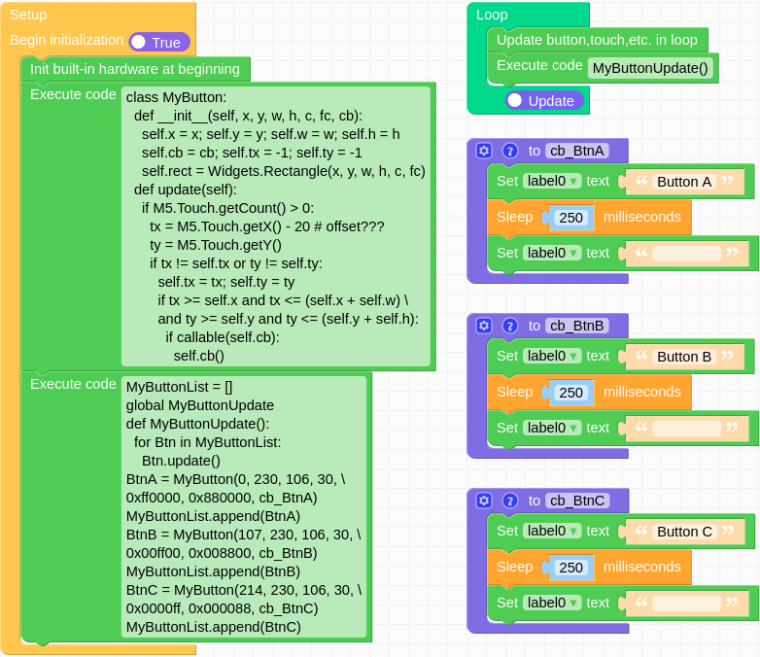

<p dir="auto">I've created an <a href="https://github.com/felmue/MyM5StackExamples/blob/main/M5CoreS3/TouchButtonABC.py" target="_blank" rel="noopener noreferrer nofollow ugc">example</a> - using a simple button class - which simulates the three buttons (BtnA, B and C) at the bottom of the display.</p>
<p dir="auto"><img src="/assets/uploads/files/1702327187465-uiflow2_m5cores3_btnabc_20231211-resized.png" alt="0_1702327184703_UIFlow2_M5CoreS3_BtnABC_20231211.png" class=" img-fluid img-markdown" /></p>
<p dir="auto">Thanks<br />

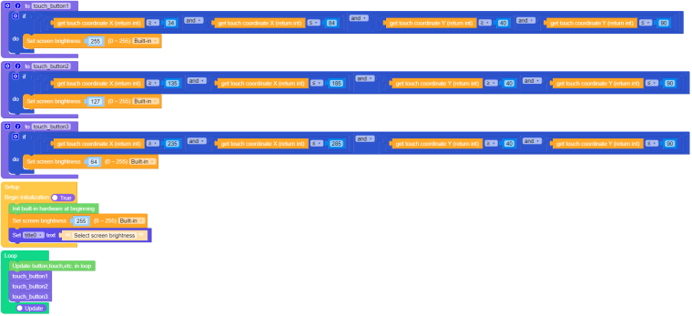

<p dir="auto">I also encountered this difficulty in UiFlow 2.0, but I was able to successfully add buttons to the screen in an alternative way, but it worked very well. The code is very simple and only serves to demonstrate a way to implement buttons on the touch screen. On the screen, there are three buttons that, when pressed, adjust the screen brightness according to the brightness percentage written on them.</p>
<p dir="auto"><img src="/assets/uploads/files/1700674926936-uiflow2_block_1700674595732-resized.png" alt="0_1700674916340_uiflow2_block_1700674595732.png" class=" img-fluid img-markdown" /></p>

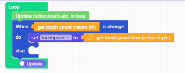

<p dir="auto">But maybe add the "Touch"  component, and the "Logic" component to your program, and see if you can do something with this type of pattern:</p>
<p dir="auto"><img src="/assets/uploads/files/1693461417421-f51a438e-9bb8-45ac-846a-fc8b277da3b6-image.png" alt="0_1693461433509_f51a438e-9bb8-45ac-846a-fc8b277da3b6-image.png" class=" img-fluid img-markdown" /></p>
<p dir="auto">(touchpoint is just a variable I added)</p>
<p dir="auto">I havent tried this - I was just looking around in UIflow2 for what could be used.</p>
<p dir="auto">It looks like you might need to manually check if a touch point is within some drawn UI feature, and handle that yourself.</p>
<p dir="auto">In any case, I couldnt find anything that looked like screen/touchbutton event handlers, only physical gpio pin push event handlers.</p>
