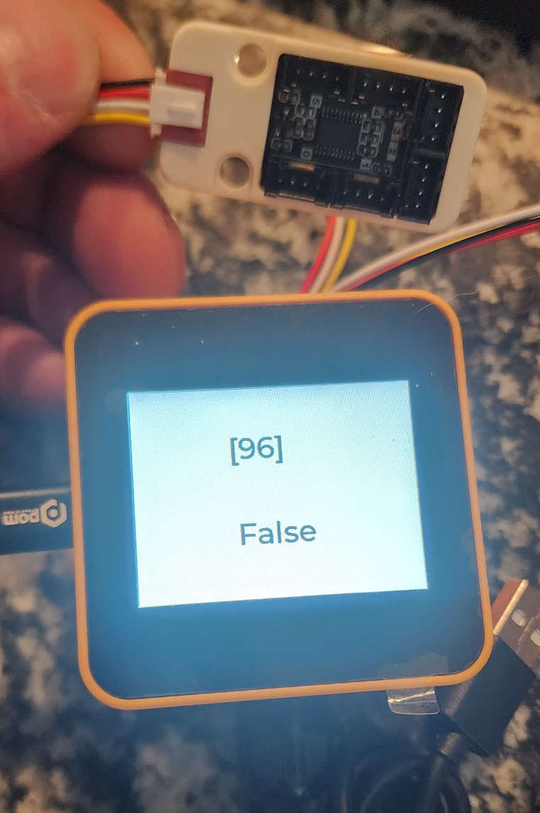

<blockquote>
<p dir="auto">97</p>
</blockquote>
<p dir="auto">I now get [97] and True. I just tried using digital and analog read. Both are working as expected. That was a really cool party trick! Where can I read more about what you walked me through. I obviously have no issues making bad code. I need to know how to clean up my own messes and how to debug. Thank you so much for the help. I appreciate it more than you know.</p>
]]></description><link>https://community.m5stack.com/post/21969</link><guid isPermaLink="true">https://community.m5stack.com/post/21969</guid><dc:creator><![CDATA[IsoEek]]></dc:creator><pubDate>Thu, 17 Aug 2023 06:23:11 GMT</pubDate></item><item><title><![CDATA[Reply to Pb.HUB will not connect. [Fixed] on Thu, 17 Aug 2023 03:42:43 GMT]]></title><description><![CDATA[<p dir="auto"><a class="plugin-mentions-user plugin-mentions-a" href="/user/isoeek" aria-label="Profile: IsoEek">@<bdi>IsoEek</bdi></a><br />
<img src="/assets/uploads/files/1692243239922-e2335b7e-3939-4742-abac-042470089fdb-image-resized.png" alt="0_1692243253849_e2335b7e-3939-4742-abac-042470089fdb-image.png" class=" img-fluid img-markdown" /></p>
<ul>
<li>
<p dir="auto">Please check again and check the result 0x61[97]</p>
</li>
<li>
<p dir="auto">If you get 0x61 result then your pbhub i2c address was changed from 0x60 to 0x61</p>
</li>
</ul>
<p dir="auto"><img src="/assets/uploads/files/1692243754951-1ad5c729-6942-4943-a699-6257d3a3432d-image.png" alt="0_1692243768795_1ad5c729-6942-4943-a699-6257d3a3432d-image.png" class=" img-fluid img-markdown" /></p>
]]></description><link>https://community.m5stack.com/post/21968</link><guid isPermaLink="true">https://community.m5stack.com/post/21968</guid><dc:creator><![CDATA[pandian.nano]]></dc:creator><pubDate>Thu, 17 Aug 2023 03:42:43 GMT</pubDate></item><item><title><![CDATA[Reply to Pb.HUB will not connect. [Fixed] on Thu, 17 Aug 2023 01:16:58 GMT]]></title><description><![CDATA[<p dir="auto">@pandian-nano Thanks. This is the out come. I looked up the Hex for 96 and I get 0x60. I believe I need to set init and/or set the new address. Is the answer as simple as using the Write Memory Data under I2C Master? Is the included block what I need to burn? I'm doing my best to learn this, but damn there is a lot to learn!</p>
