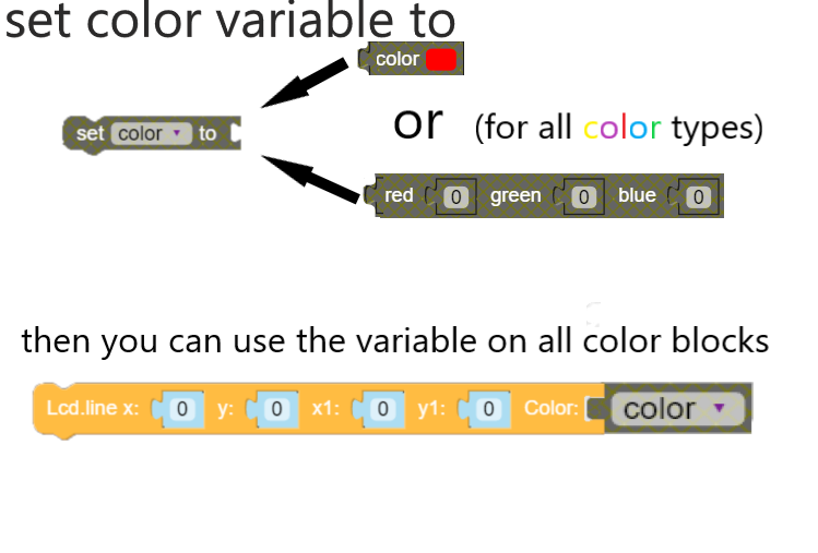

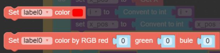

Also it would be really great to change the way color is defined in Uiflow. The main reason I am asking for this is that you only offer the color swatch on the graphic blocks and I need those blocks to have red,green,blue number values. At the moment you have some blocks that use color as a color swatch and others that use color as a number for red, green, and blue.<br />
<img src="/assets/uploads/files/1548744187182-color-resized.png" alt="0_1548744171761_color.PNG" class=" img-fluid img-markdown" /><br />
I think this can be consolidated into a color variable that can be defined using either the color swatch or the red,green,blue numeric values and then this color variable can be used where ever color gets defined.</p>
<p dir="auto"><img src="/assets/uploads/files/1548744503096-color_blocks.png" alt="0_1548744487032_color_blocks.png" class=" img-fluid img-markdown" /></p>
</blockquote>
<p dir="auto">Nice suggestion, their colour system would certainly simplify things quite a bit.</p>

<p dir="auto">Great idea about the colours, we should aim for consistency. Have you noticed the new custom blocks function in the latest version of Ui flow, I think its a great step in the right direction and I'm thinking about how best we can streamline and manage any new interesting blocks our community comes up with. I'll be taking a good look through all of the blocks in Uiflow for bugs and potential improvements over cny and preparing a doc to present to the team after the holiday, would be happy to hear of any other suggestions you have.</p>
