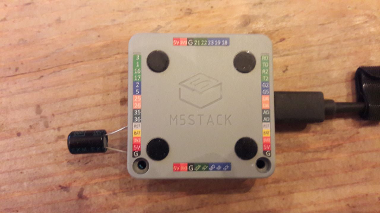

<?xml version="1.0" encoding="UTF-8"?><rss xmlns:dc="http://purl.org/dc/elements/1.1/" xmlns:content="http://purl.org/rss/1.0/modules/content/" xmlns:atom="http://www.w3.org/2005/Atom" version="2.0"><channel><title><![CDATA[Simple fix when upload fails.]]></title><description><![CDATA[<p dir="auto">Add a small capacitor like 2,2uF between Ground and RST<br />
<img src="/assets/uploads/files/1513449889987-m5stack_fix_s-resized.jpg" alt="0_1513449887935_m5stack_fix_s.jpg" class=" img-fluid img-markdown" /></p>
]]></description><link>https://community.m5stack.com/topic/56/simple-fix-when-upload-fails</link><generator>RSS for Node</generator><lastBuildDate>Wed, 29 Apr 2026 08:40:45 GMT</lastBuildDate><atom:link href="https://community.m5stack.com/topic/56.rss" rel="self" type="application/rss+xml"/><pubDate>Sat, 16 Dec 2017 18:44:52 GMT</pubDate><ttl>60</ttl><item><title><![CDATA[Reply to Simple fix when upload fails. on Thu, 28 Dec 2017 23:31:17 GMT]]></title><description><![CDATA[<p dir="auto">If you do not have a capacitor available, you can also try to set the "Upload Speed" to 115200 in Arduino IDE.<br />
Of course the uploads are longer, but it did the job for me : i did not have any upload error since</p>
<p dir="auto">I also installed the latest CP210x Windows driver (v10.1.1 for Windows 10) but i don't think this is necessary</p>
]]></description><link>https://community.m5stack.com/post/125</link><guid isPermaLink="true">https://community.m5stack.com/post/125</guid><dc:creator><![CDATA[mathdb]]></dc:creator><pubDate>Thu, 28 Dec 2017 23:31:17 GMT</pubDate></item><item><title><![CDATA[Reply to Simple fix when upload fails. on Sat, 23 Dec 2017 08:25:12 GMT]]></title><description><![CDATA[<p dir="auto">One nice way for a permanent fix would be to solder the capacitor inside of the Proto board with extenasion:</p>
<p dir="auto"><a href="https://www.aliexpress.com/item/M5Stack-Official-Stock-Offer-Proto-Module-Proto-Board-with-Extension-Bus-Socket-for-Arduino-ESP32-Development/32843231933.html" target="_blank" rel="noopener noreferrer nofollow ugc">https://www.aliexpress.com/item/M5Stack-Official-Stock-Offer-Proto-Module-Proto-Board-with-Extension-Bus-Socket-for-Arduino-ESP32-Development/32843231933.html</a></p>
<p dir="auto">But this is not sold seperatly at all.</p>
]]></description><link>https://community.m5stack.com/post/115</link><guid isPermaLink="true">https://community.m5stack.com/post/115</guid><dc:creator><![CDATA[SR]]></dc:creator><pubDate>Sat, 23 Dec 2017 08:25:12 GMT</pubDate></item><item><title><![CDATA[Reply to Simple fix when upload fails. on Fri, 22 Dec 2017 20:17:18 GMT]]></title><description><![CDATA[<p dir="auto">I've got the same problem.</p>
<p dir="auto">By adding a capacitor, I was also able to solve the issue. But for me this looks more like a weak reset circuit in the M5Stack board rather than a drive issue. At leat adding the capacitor is is more a workaround rather than a solution.</p>
]]></description><link>https://community.m5stack.com/post/114</link><guid isPermaLink="true">https://community.m5stack.com/post/114</guid><dc:creator><![CDATA[SR]]></dc:creator><pubDate>Fri, 22 Dec 2017 20:17:18 GMT</pubDate></item><item><title><![CDATA[Reply to Simple fix when upload fails. on Fri, 22 Dec 2017 19:40:56 GMT]]></title><description><![CDATA[<p dir="auto">Can we solder a permanent 2.2uF small capacitor INSIDE the box or ... ?</p>
]]></description><link>https://community.m5stack.com/post/112</link><guid isPermaLink="true">https://community.m5stack.com/post/112</guid><dc:creator><![CDATA[anichang]]></dc:creator><pubDate>Fri, 22 Dec 2017 19:40:56 GMT</pubDate></item><item><title><![CDATA[Reply to Simple fix when upload fails. on Tue, 19 Dec 2017 12:43:30 GMT]]></title><description><![CDATA[<p dir="auto">Can confirm. Similar issue to the old 8266.<br />
Ripple on the RST pin causing resets whilst communicating. I used a 10uF successfully after trying all available CP210X drivers without success.</p>
]]></description><link>https://community.m5stack.com/post/107</link><guid isPermaLink="true">https://community.m5stack.com/post/107</guid><dc:creator><![CDATA[Anthony]]></dc:creator><pubDate>Tue, 19 Dec 2017 12:43:30 GMT</pubDate></item></channel></rss>
