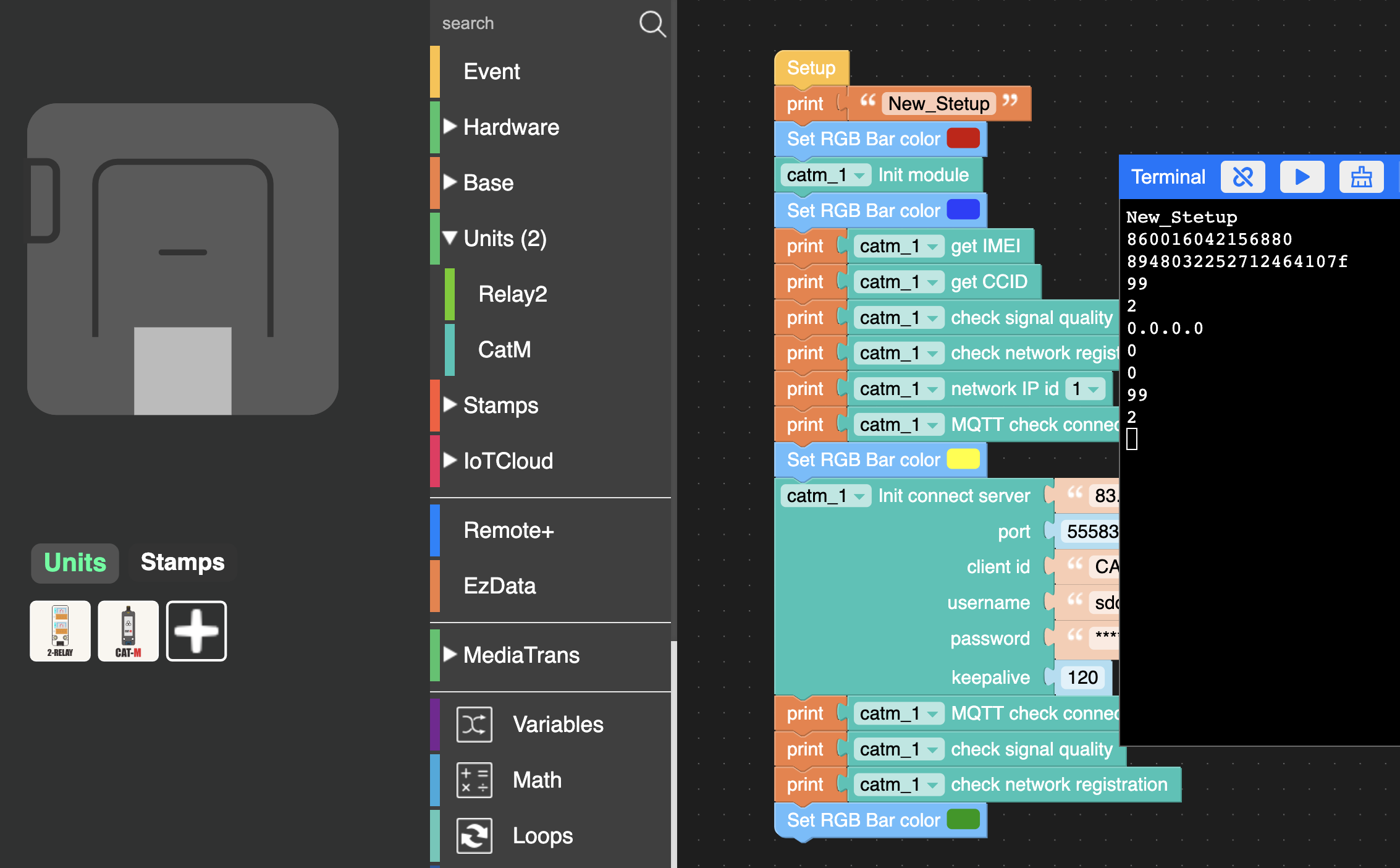

<?xml version="1.0" encoding="UTF-8"?><rss xmlns:dc="http://purl.org/dc/elements/1.1/" xmlns:content="http://purl.org/rss/1.0/modules/content/" xmlns:atom="http://www.w3.org/2005/Atom" version="2.0"><channel><title><![CDATA[U128 CATM @ Atom Lite and AtmoS3 Lite @ UiFlow v1 and v2]]></title><description><![CDATA[<p dir="auto">Hi, I'm trying to run a project that can control a relay using LTE-M communication.<br />
I'm working with the CATM (U128)<br />
<a href="https://docs.m5stack.com/en/unit/cat_m" target="_blank" rel="noopener noreferrer nofollow ugc">https://docs.m5stack.com/en/unit/cat_m</a></p>
<p dir="auto">I'm using two different modules: Atom Lite and AtomS3 Lite, so in UiFlow v1 and UiFlow v2. While UiFlow1 has an additional CATM UNIT, UiFlow2 does not.</p>
<p dir="auto">In M5Burner, I've set com.x to True and set the APN as required for my SIM card.<br />
Does anyone have a ready-to-use project built with blocks using MQTT? Either for UiFlow 1 or 2. Because I can't get it to work.</p>
<p dir="auto">While I've built a program on Wi-Fi that sends and receives MQTT, with the CATM I don't receive any IP as if it's not connecting to the internet.</p>
<p dir="auto">On the module's page, there's only an example for Arduino and I'm looking for one for UiFlow.<br />
Below, I've attached a screenshot of the blocks and while I can retrieve IMEI or CCID queries, I'm unable to connect to the internet.</p>
<p dir="auto">The SIM card is tested on Mikrotik KNOT, where I also have LTE-M and I can send and receive MQTT there. The PIN is turned off.</p>
<p dir="auto">I'd greatly appreciate any support on what and how I can check why I'm not getting an IP address. Thanks.</p>

<p dir="auto">Thank you very much for your assistance. After manually configuring the APN via AT commands, everything is working perfectly. The pass-through example with UART2: TX = 26, RX = 32 was very helpful.</p>
<p dir="auto">Thanks again,<br />
[Marek]<br />

<p dir="auto">Thank you very much for your response. Do you have any sample working code for UiFlow with CATM?</p>
<p dir="auto">The mentioned blue light blinks every 800ms, indicating no network connection. I tried the SIM card again on Mikrotik KNOT, and it works there. Hence, I assume that the SIM card is fine.</p>
<p dir="auto">Maybe the Polish provider Orange doesn't automatically assign the APN. How can I configure the APN using AT commands?</p>
<p dir="auto">Thank you.</p>
