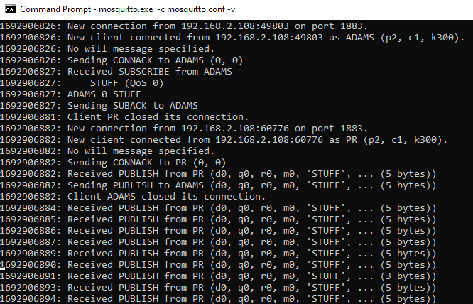

<p dir="auto">having two devices using the same IP address is never a good thing in any network.</p>
<p dir="auto">The other thing which needs to be different between clients is the MQTT client id as it is used by the Mosquitto broker to distinguish between clients.</p>

I was able to set up one Core2 to publish to a local Mosquitto server successfully. It connects, and I am able to see the data being published. This was all done with the LAN Module and the code you directed me to. Now I have a second Core2 connected to another LAN Module that I want to use as a Subscriber on the same Mosquitto server. It connects to the server, but it closes its connection when the data that it is subscribing to gets published. Is there something else that I have to do to properly configure a subscriber? I noticed that both devices have the same IP address. Is that messing things up?<br />
Here is the new code:</p>

<p dir="auto">Here is the Mosquitto log:<br />
<img src="/assets/uploads/files/1692907824540-c0f730e9-f7ec-4bd8-a0fe-db84102998ea-image.png" alt="0_1692907839975_c0f730e9-f7ec-4bd8-a0fe-db84102998ea-image.png" class=" img-fluid img-markdown" /></p>
