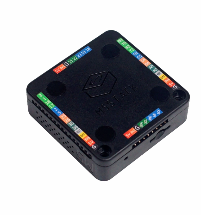

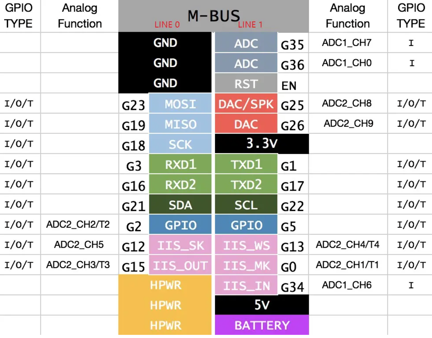

]]></description><link>https://community.m5stack.com/post/22070</link><guid isPermaLink="true">https://community.m5stack.com/post/22070</guid><dc:creator><![CDATA[mtylerjr]]></dc:creator><pubDate>Sat, 26 Aug 2023 03:17:15 GMT</pubDate></item><item><title><![CDATA[Reply to Connecting M5stack to PCB with header and GPIO capacity. on Fri, 25 Aug 2023 19:04:01 GMT]]></title><description><![CDATA[<p dir="auto"><a class="plugin-mentions-user plugin-mentions-a" href="/user/haavardmk" aria-label="Profile: haavardmk">@<bdi>haavardmk</bdi></a> In My Opinion the brilliant M5Stack Core series were meant for stand-alone use and could be mounted on a DIN rail, and many other types.</p>
<p dir="auto">But...they DO sell this set of 10 M-BUS connectors!<br />
<a href="https://shop.m5stack.com/collections/m5-accessories/products/2-15-pin-header-socket-for-13-2-module-10pcs" target="_blank" rel="noopener noreferrer nofollow ugc">https://shop.m5stack.com/collections/m5-accessories/products/2-15-pin-header-socket-for-13-2-module-10pcs</a><br />
As you know the M-BUS breaks out I2C, SPI and GPIO, two power voltages and grounds !<br />
Core Basic:<br />
<img src="/assets/uploads/files/1692990232861-screenshot-2023-08-25-at-3.03.52-pm-resized.png" alt="0_1692990246751_Screenshot 2023-08-25 at 3.03.52 PM.png" class=" img-fluid img-markdown" /><br />
Again IMHO I feel the lack of pins that many many Arduino, ESP32, M5Stack hobbyists anguish over can be overcome with I2C and ESP_NOW!<br />
-Terry</p>

]]></description><link>https://community.m5stack.com/post/22060</link><guid isPermaLink="true">https://community.m5stack.com/post/22060</guid><dc:creator><![CDATA[haavardmk]]></dc:creator><pubDate>Fri, 25 Aug 2023 08:11:46 GMT</pubDate></item><item><title><![CDATA[Reply to Connecting M5stack to PCB with header and GPIO capacity. on Thu, 24 Aug 2023 19:38:08 GMT]]></title><description><![CDATA[<p dir="auto"><a class="plugin-mentions-user plugin-mentions-a" href="/user/mtylerjr" aria-label="Profile: mtylerjr">@<bdi>mtylerjr</bdi></a> The Core Basic has 15 GPIO peripherally arranged in the battery base, as well as generous grounds and voltage options.</p>
<p dir="auto"><img src="/assets/uploads/files/1692905795687-screenshot-2023-08-24-at-3.36.31-pm-resized.png" alt="0_1692905810450_Screenshot 2023-08-24 at 3.36.31 PM.png" class=" img-fluid img-markdown" /></p>
]]></description><link>https://community.m5stack.com/post/22054</link><guid isPermaLink="true">https://community.m5stack.com/post/22054</guid><dc:creator><![CDATA[teastain]]></dc:creator><pubDate>Thu, 24 Aug 2023 19:38:08 GMT</pubDate></item><item><title><![CDATA[Reply to Connecting M5stack to PCB with header and GPIO capacity. on Thu, 24 Aug 2023 10:01:04 GMT]]></title><description><![CDATA[<p dir="auto">Hmm GPIOs 26/27 may not exist on the CoreS3 after all</p>

Sidenote: The unique thing about the Core Basic is that it comes with a lot of I/O broken out at the sides of the base/battery box.<br />
<img src="/assets/uploads/files/1692906499923-screenshot-2023-08-24-at-3.36.31-pm-resized.png" alt="0_1692906515167_Screenshot 2023-08-24 at 3.36.31 PM.png" class=" img-fluid img-markdown" /><br />
Two sides are female connectors and the other two sides are the directly corresponding male pins.<br />
This was in a time gone by where beginner projects had a lot of single pin discrete sensors.<br />
Later, the built-in I2C became more popular and of now my big HVAC desktop controller has zero discretes, one I2C temp sensor and the rest of the I/O is the built-in ESP_NOW, which is amazing.<br />
-Terry</p>

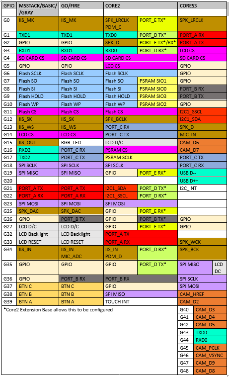

<p dir="auto">This is what I ended up with, but keep in mind it is not m5stack official, just what I could piece together.</p>
<p dir="auto">it looks like you -<em>might</em>-  potentially have 10 available on the S3, including the 4 used by actual B and C ports.</p>
<p dir="auto">GPIO #s:<br />
5,6,7,8,9,10,17,18,26,27</p>
<p dir="auto"><img src="/assets/uploads/files/1692833155232-17b701d8-9403-4524-b54e-c6f0a020fd8c-image.png" alt="0_1692833172117_17b701d8-9403-4524-b54e-c6f0a020fd8c-image.png" class=" img-fluid img-markdown" /></p>
