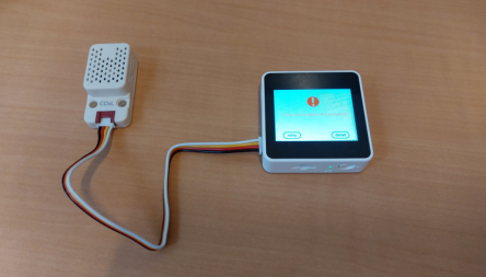

<p dir="auto">I am new to M5Stack and started to play with small things to learn. After playing with basic UI controls (which works great), I wanted to use some external sensor and connected my CO2L unit to port A.</p>
<p dir="auto">My current setup is thus made of a CORE2 connected to a CO2L unit, and I am using uiflow.</p>
<p dir="auto"><img src="/assets/uploads/files/1692889849709-screenshot_20230824_170417.png" alt="0_1692889775167_Screenshot_20230824_170417.png" class=" img-fluid img-markdown" /></p>
<p dir="auto">I reduced the test progam to the bare minimum: I declared the CO2L unit and left everything else empty. This results in the following micropython code:</p>

<p dir="auto">So, I am stuck with a "CO2 unit maybe not connect" error message as if nothing was connected.  Am I doing something wrong, or is the sensor faulty (I just received it)?<br />
Is there any way to debug?</p>

After a first run the sketch reported errors, the demo program uses Ubuntu font that does not exist on Core 2 UIFlow 1.12.3... I replaced all the labels fonts by default and yes the sensor works on Core 2<img src="/assets/uploads/files/1692954031261-co2sensor-resized.jpg" alt="0_1692954046604_CO2sensor.jpg" class=" img-fluid img-markdown" /></p>
